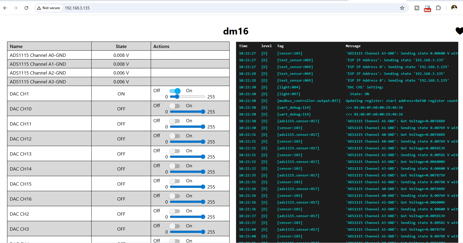

DM16 ESPHome yaml for home assistant without tuya
  friendly_name: dm16

esphome yaml file download:
.txt   DM16-HA-without Tuya.txt (Size: 9.49 KB / Downloads: 422)
