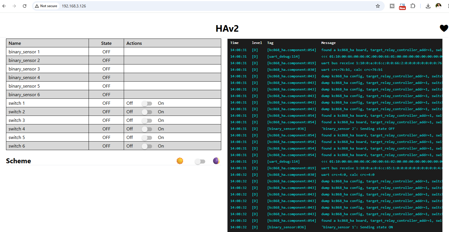

F24 work with HAv2 with tuya app ESPHome yaml
  friendly_name: f24

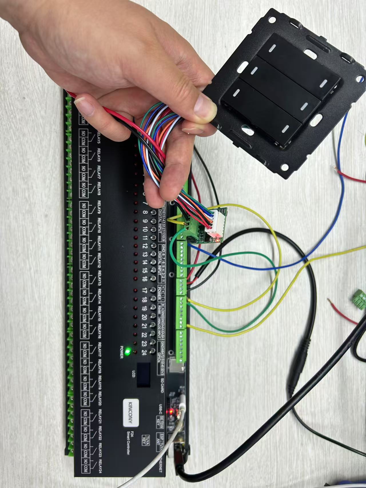

kc868_ha:
  uart_id: myuart1

  # The switch is used to control the D1~D6 level output on the KC868 HA board
  # bind_output is required. Corresponds to the BindOutput parameter in HA485_Ctrl software
  # Other parameters refer to: https://esphome.io/components/switch/index.html
  - platform: kc868_ha
    target_relay_controller_addr: 1
    switch_adapter_addr: 10
    bind_output: 1
