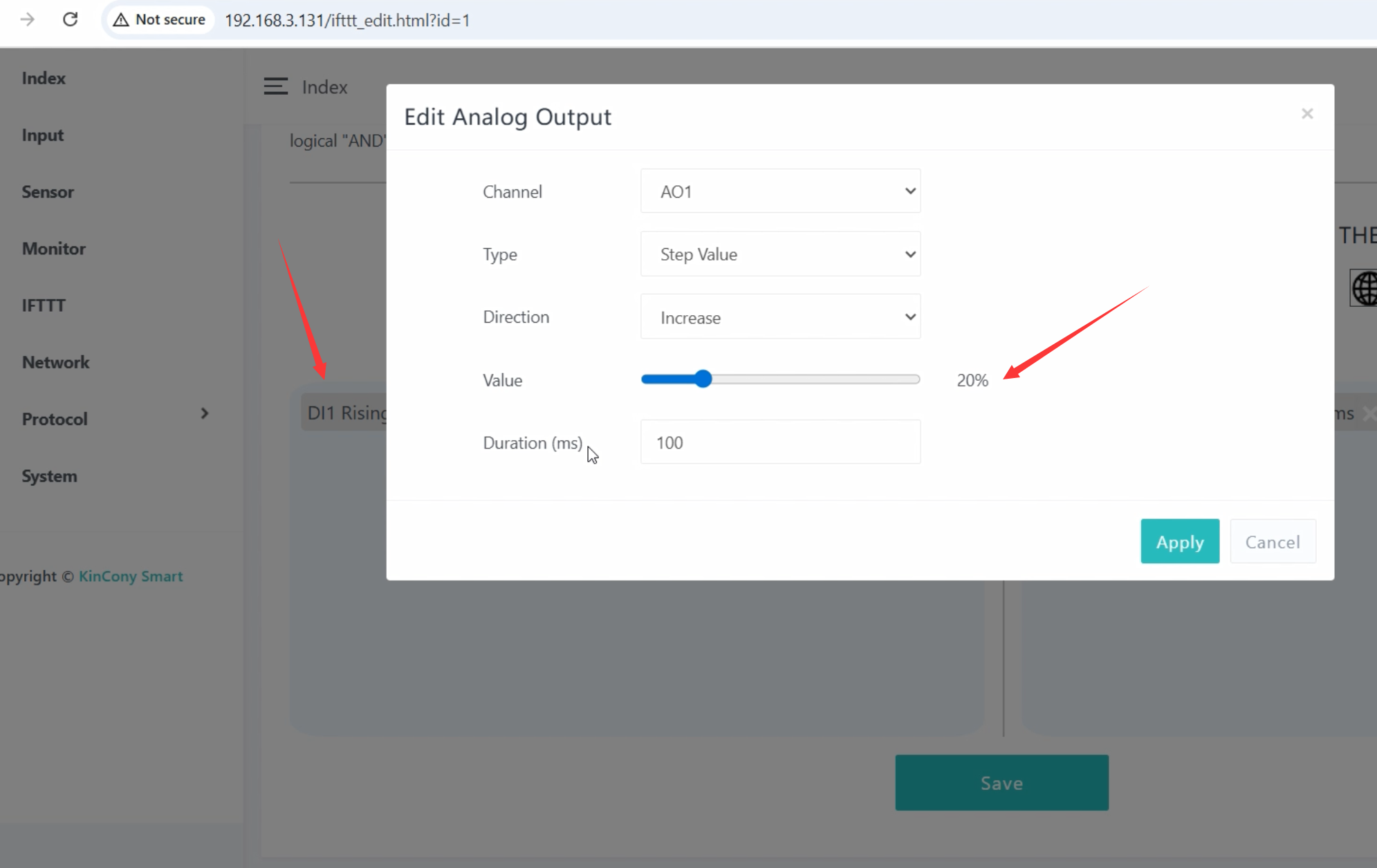

if you use digital input for button, that according to set by IFTTT what per cent will be changed.
can you take a video to explain your question?

my means, how about set by IFTTT. or you MUST want change the 20% value by MQTT?
I am not familiar with IFTTT. Is it possible to set it programatically or only via web interface as your screenshot depict? I would ideally need some kind of API like MQTT, HTTP, TCP, etc. If this is not possible then it's fine. I'll implement a workaround. But it would be nice to have feature.
Also I cannot see the IFTTT panel in the web interface of my KC868-D16 dimmer. My firmware is D16_V1.08. Is it possible to flash KCS to get the IFTTT and other features?
i see. you are using KC868-D16, not DM16 new esp32 controller. sorry, D16 don't support that function.
