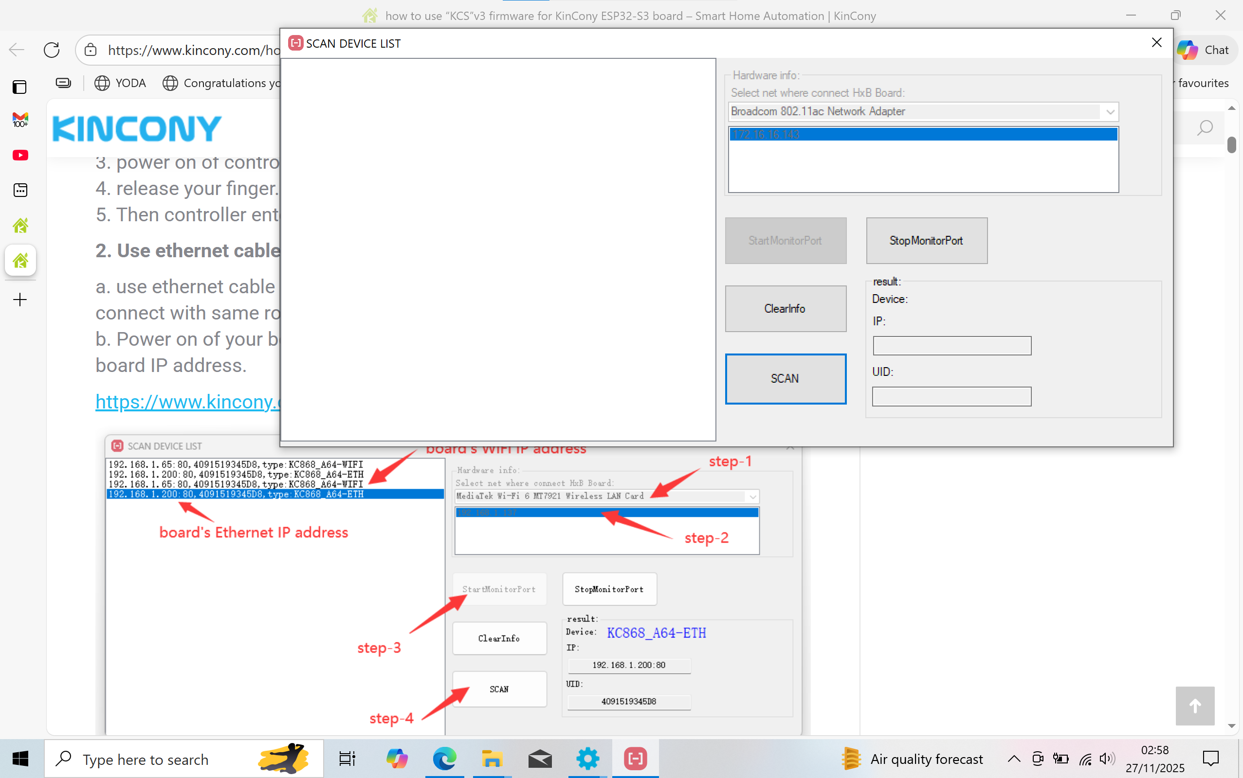

Hello I am trying to get the programme operating and functional from my MacBook and then transfer it onto the N30 system although I have these issues below:
1. THE SCAN start doesn't populate like the tutorial see the attached screen shot.
2. It doesn't pick up the IP and the UID
thanks cheers

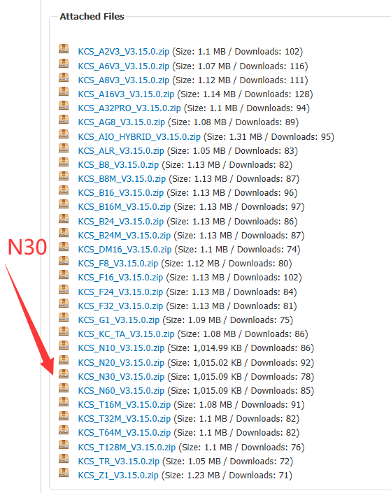

you need to download KCS v3 firmware by USB-C cable for N30 firstly.
here is firmware download link: https://www.kincony.com/forum/showthread.php?tid=8687
how to download and use KCS v3 firmware, here is online guide: https://www.kincony.com/how-to-use-kcsv3...board.html
https://www.kincony.com/how-to-use-kcsv3...meter.html

which download ?

download N30, do you see it?

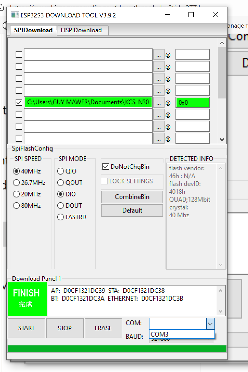

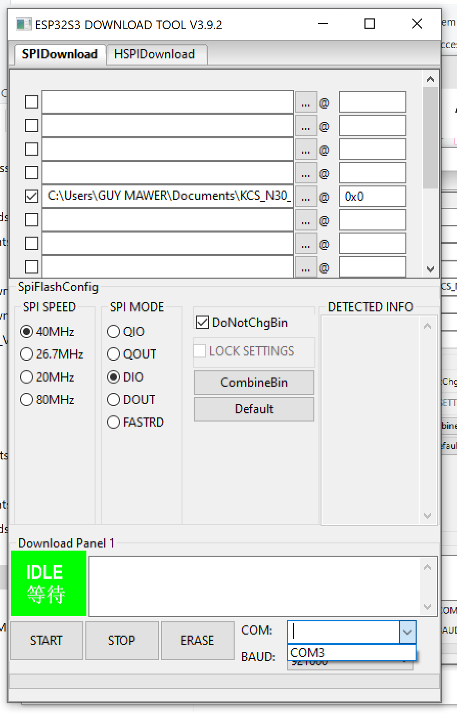

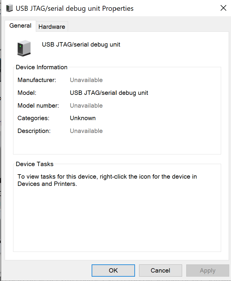

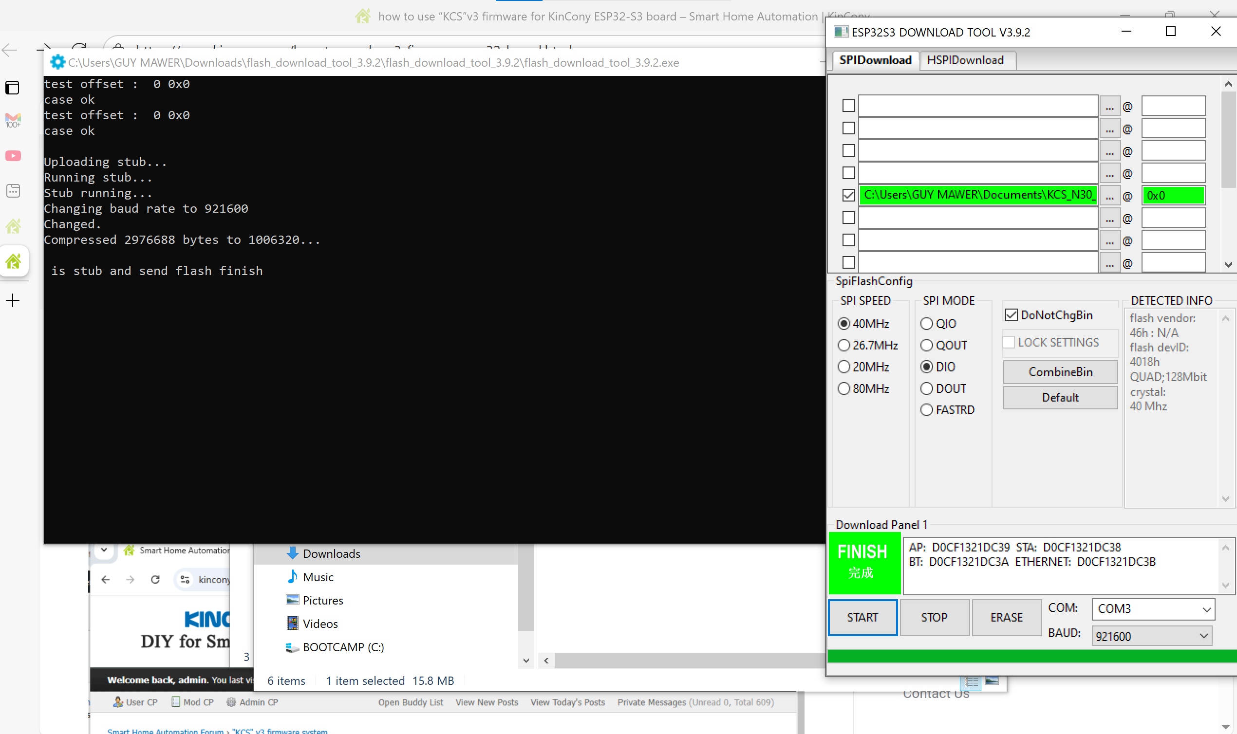

ill show you the issue i have there is nothing that says usb only the com3 see below how do i fix that ?
here is the issue not sure how to fix this ?
if you can't find your com port. (connect with USB-C cable and power supply) you can try :
1. power off N30
2. hold on DW (download) button, don't move your finger.
3. power on of N30
4. release your finger.
5. Then N30 enter bootloader mode. download firmware again.

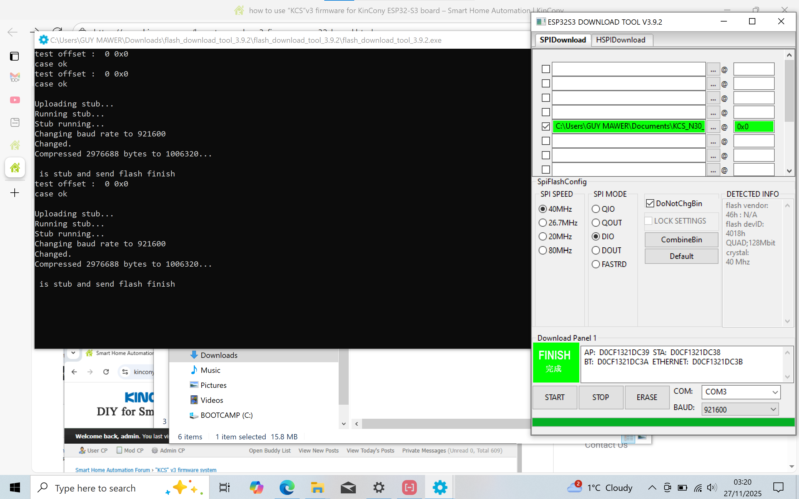

I did all of what you said and still the same problem. I've restarted my computer turned off the N30 AND ON AGAIN same problem now a blank screen.  There seems to be a problem with the N30.
SEE 2 SCREEN SHOTS BELOW.

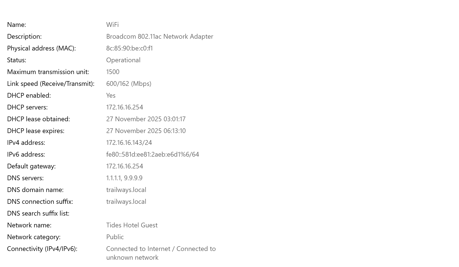

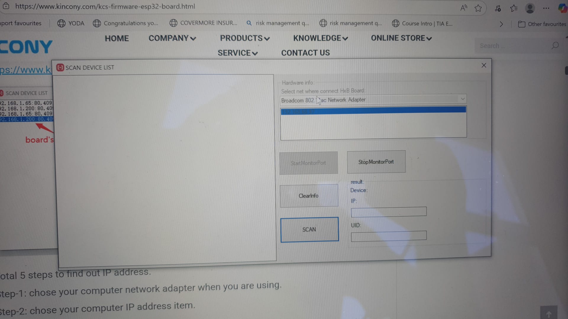

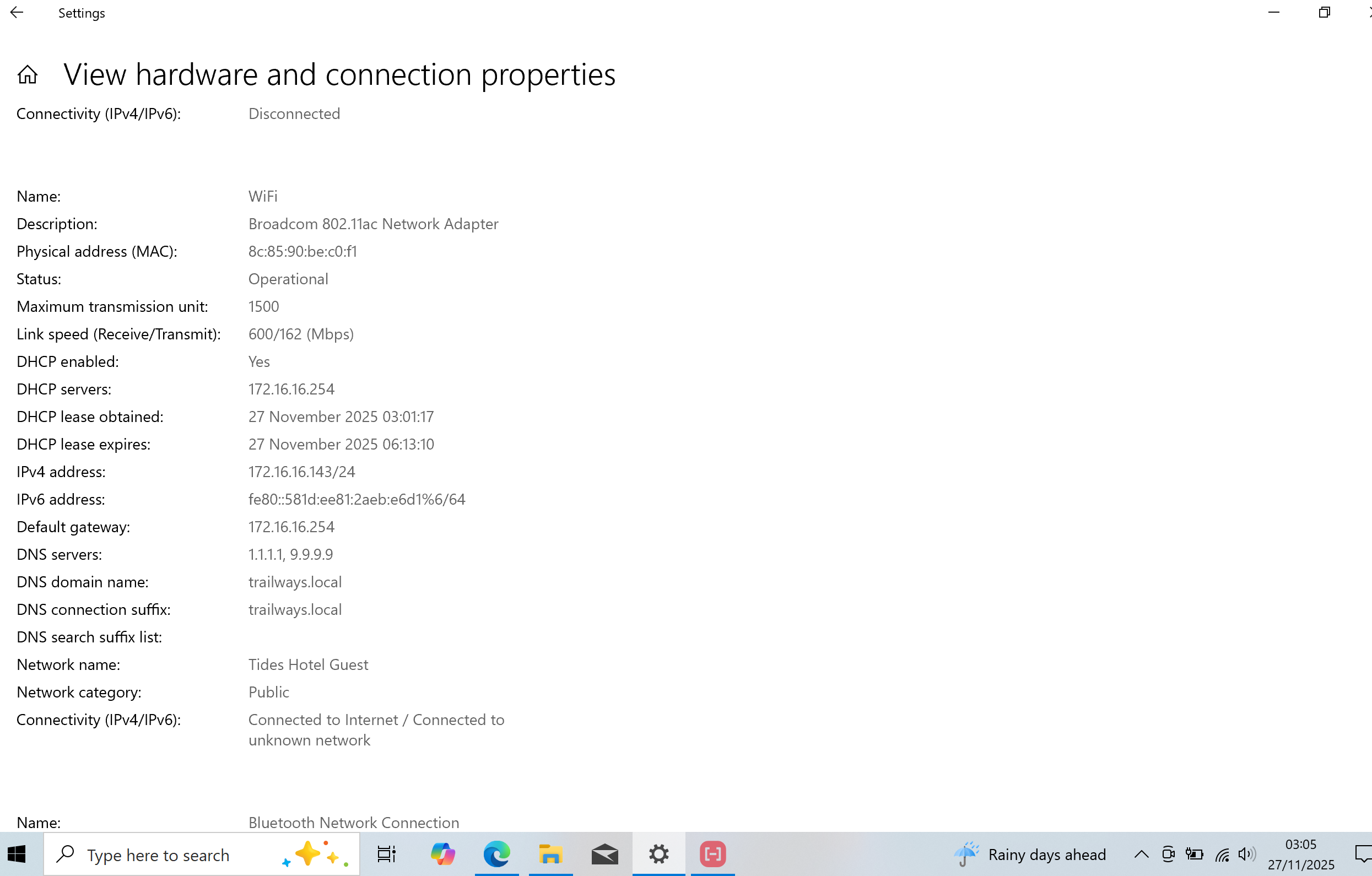

another issue is my computer doesn't seem to pick up the N30 on WIFI. the machine seems to be connected to the WIFI connection but when i run the SCAN DEVICE LIST it doesn't pick anything up.
I have attached all the screen shots of the issues:
the picture showed you have downloaded kCS v3 firmware successfully.
after you downloaded firmware, MUST re power on of N30.
another tip: you should let your N30 and computer connect to same router, just in one local network.
