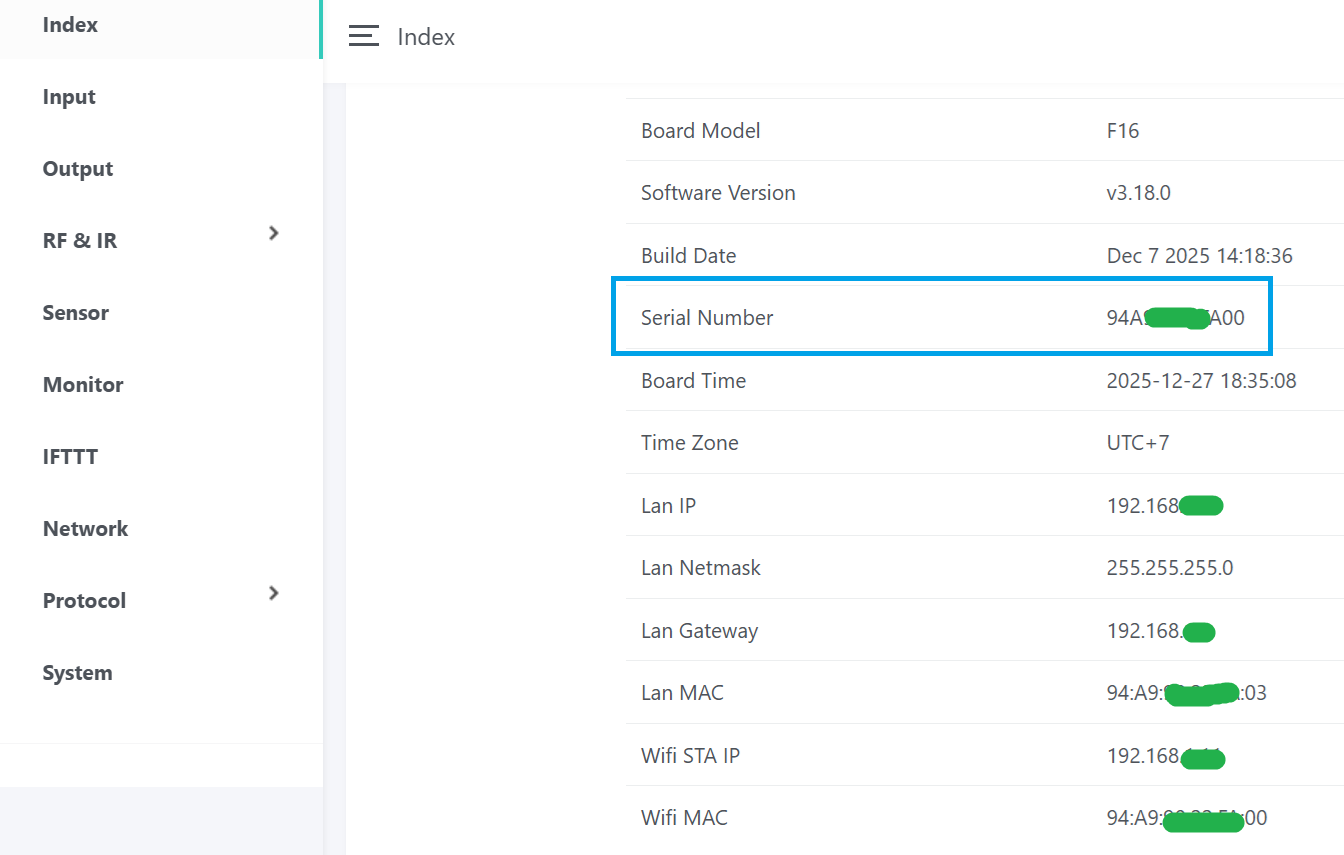

and how to get the Device Serial Number from Arduino?
arduino code and KCS firmware can't use at the same time.

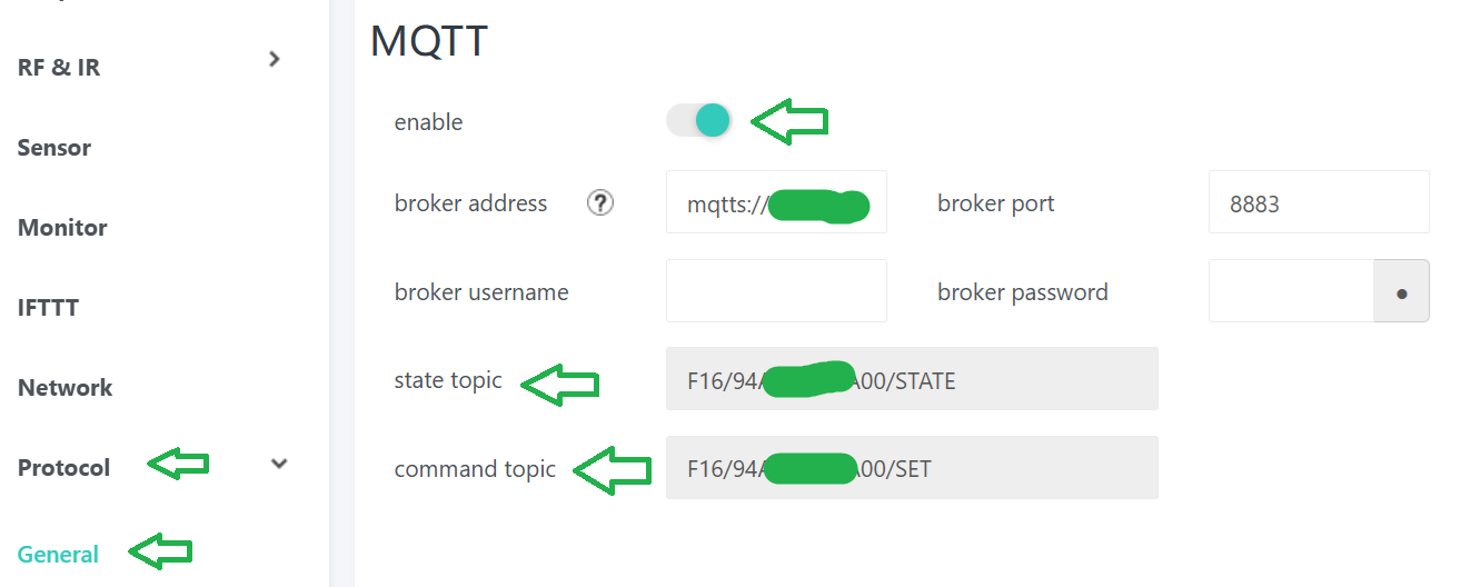

I tried to configure MQTT F16 like in the picture below.
the next question is:
1. is it correct for this configuration setting?
    Protocol -> General: MQTT enable [on]
    input broker address on the cloud server, and the port.
    i will filled user name & password later.
2. what is the state topic meaning? it look like mac address for the wifi/lan with addition string F16 & STATE
3. what is the command topic meaning? also it same like above. but addition string is SET
