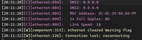

Hi, I just received a new  board. I cant accees it through ethernet. I guess the kcs comes with dhcp enabled. if yes, I cant see it with a scanner, I cant find it with the kincony scan tool. I reflashed with esp home and the A8 yaml file, no way. I reflash with the kincony flashing tool and kscv3, no way. The port I am using on the switch is fine, thats the one I am using for my PC . By the way, the board is V1.7.1, I is it the new board? I hope so, I just got it, expecting to use it with 1wire sensors expecting the kcs v3 to solve my 1wire instable sensors issue.

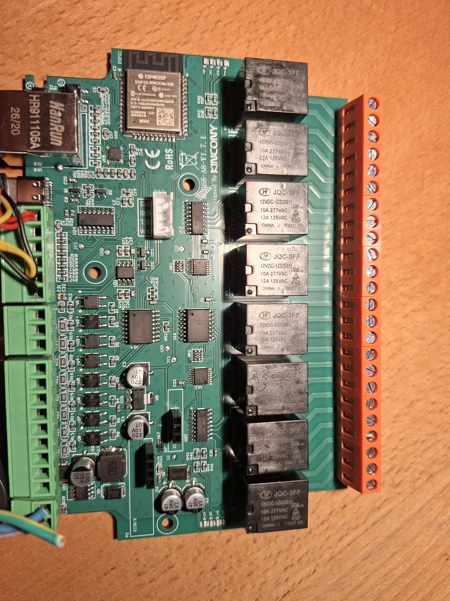

take a photo of your pcb.
the picture
picture, did you get it?
you need download KCS v2 firmware by usb-c cable firstly.

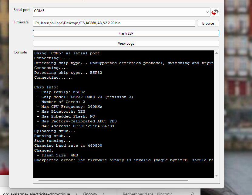

just downloaded the kcs v2.20 from your site
ok flash is ok with your tool, but do not work with the esp one. Please tell me if this board can resceive V3. I need a board for 1wire sensors, the site says v3 solve the stability pbs of the sensors.
The flashing process does not stop, its stayed on sync and the page is filled with dots, and goes on, goes on. First time I have so many pbs with my 5 kincony boards.

KCS v3 use for KC868-A8v3 board, that made by ESP32S3.
I ordered a board 3 weeks ago, why did i receive an old one? I need to get a better solution for 1 wire sensors, if you say that kcs 2 must be replaced with V3 and you produce a new board replacing the 1,7,1, why am I receiving an old one, without warning?? Not happy at all for all this time lost
