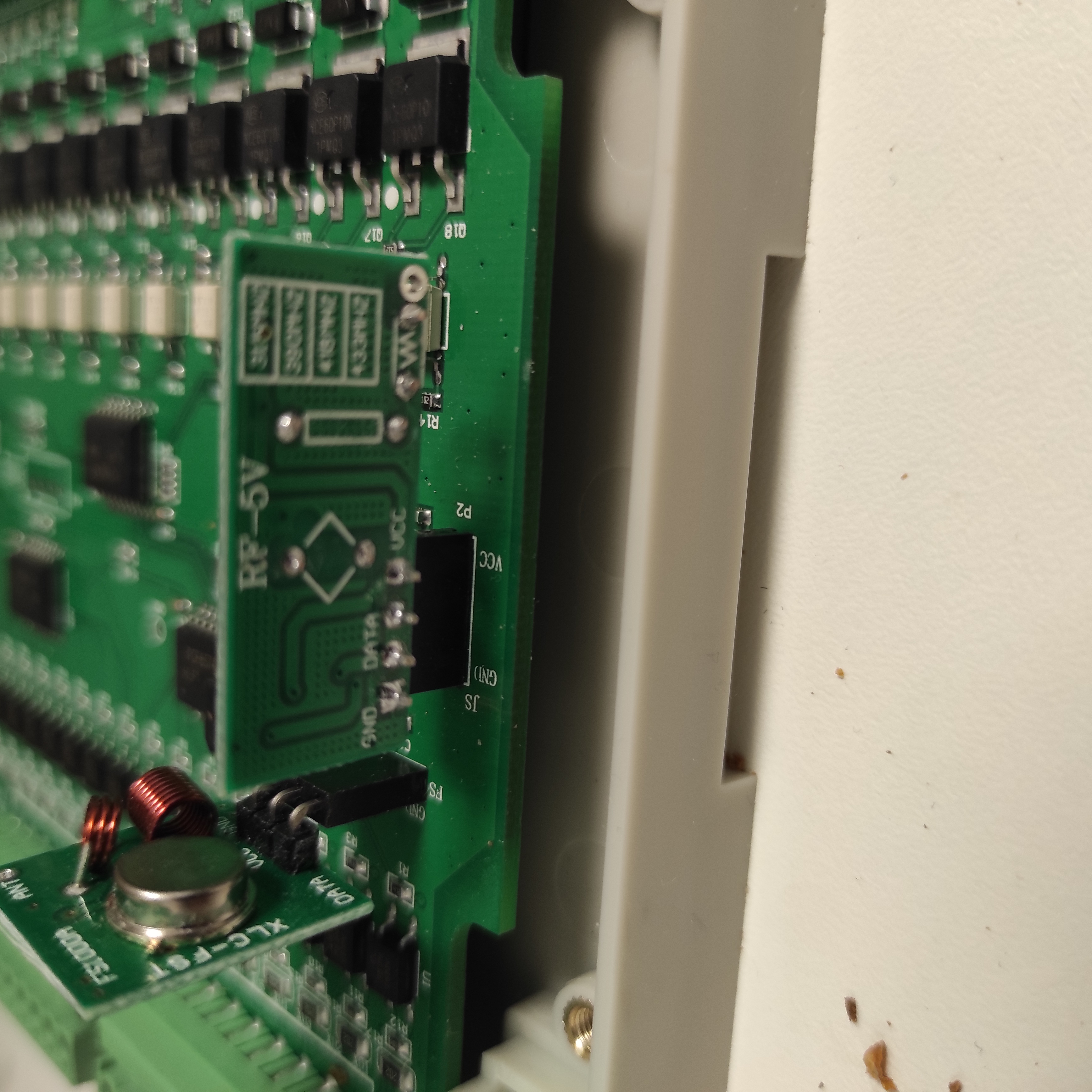

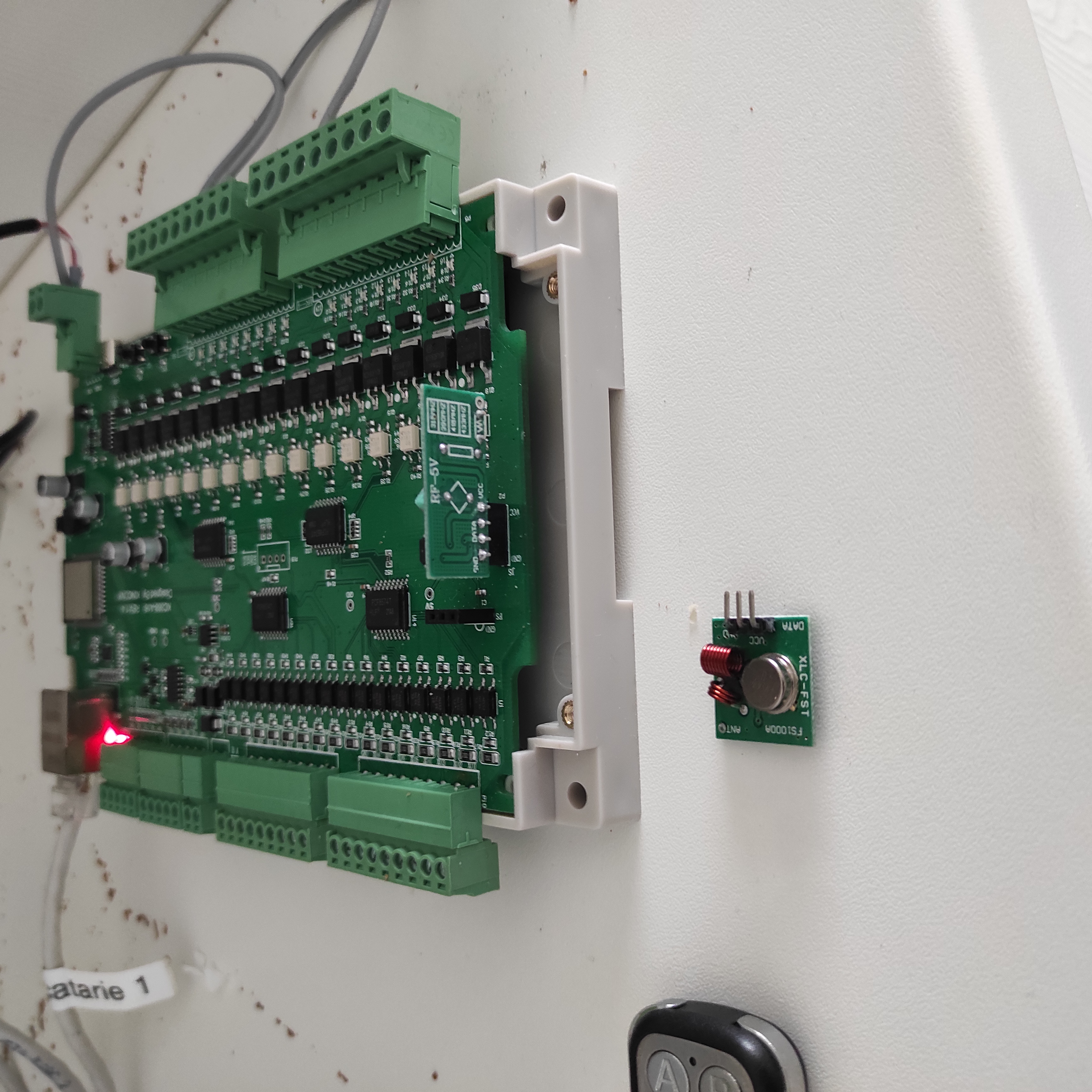

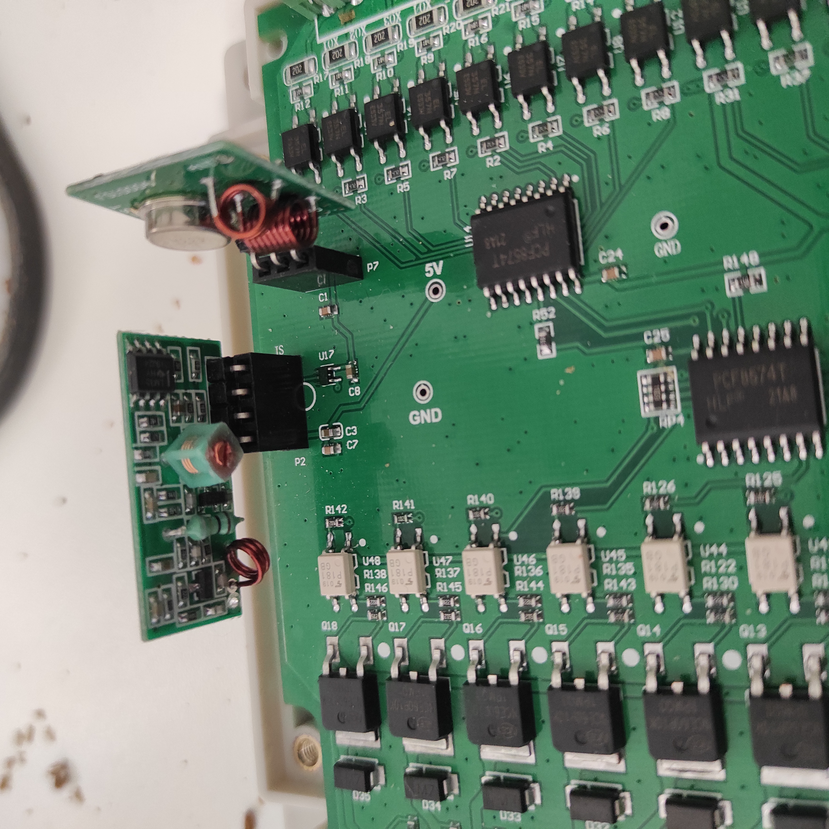

(03-17-2022, 11:13 PM)admin Wrote: i seen the video, now take a photo of your A16 pcb receiver module.
These are the pictures
RE: K868-A16 433 RF MHz receiver - admin - 03-17-2022
your transmiter module is install direction is reversed, it's wrong. i suggest you remove your transmiter module (the smallest square) for a test.

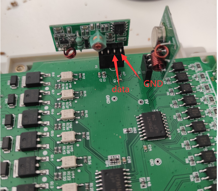

i think you can test whether have signal output in RF 433MHz receiver's "DATA" pin.

RE: K868-A16 433 RF MHz receiver - admin - 03-18-2022
the pin "DATA" with "GND" , whether voltage will changed when you press the remoter's any button.
