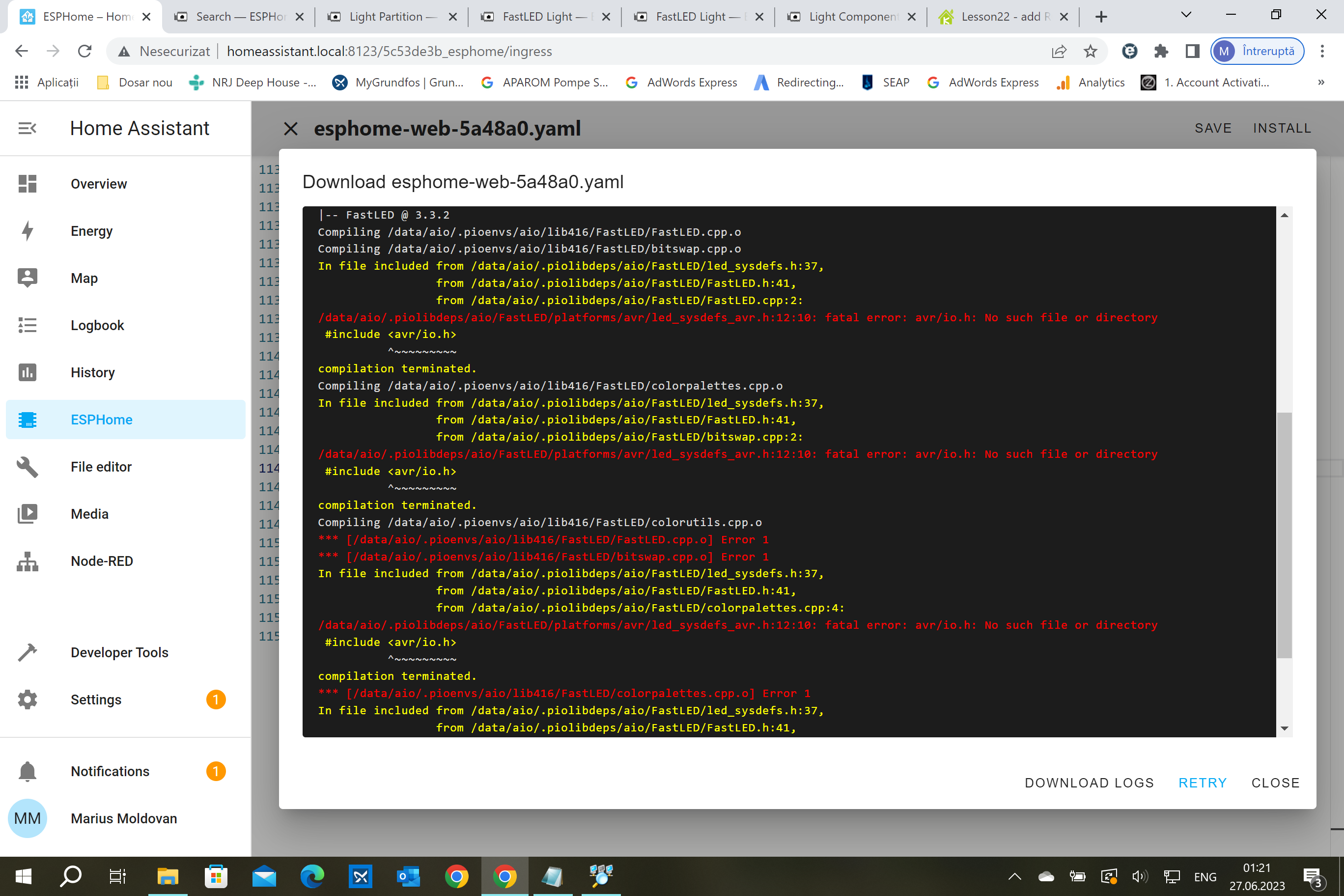

RE: Lesson22 - add RGBW LED strip to home assistant by ESPHome - MariusM - 06-26-2023
Can you advise why i get this errors ?
RE: Lesson22 - add RGBW LED strip to home assistant by ESPHome - admin - 06-27-2023
i think your config yaml is wrong, chosed wrong chip type. it's not AVR.
RE: Lesson22 - add RGBW LED strip to home assistant by ESPHome - MariusM - 07-06-2023
(06-27-2023, 05:15 AM)admin Wrote: i think your config yaml is wrong, chosed wrong chip type. it's not AVR.
I resolved the issue by reinstalling home assistant and added and ssd extention via USB to compute module and i moved all the data to ssd.
Now all working smooth.
