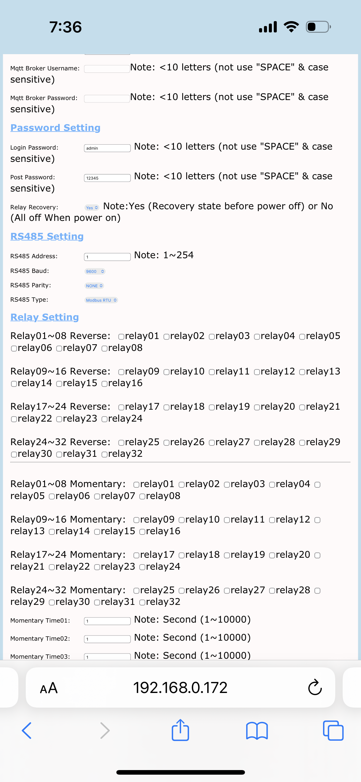

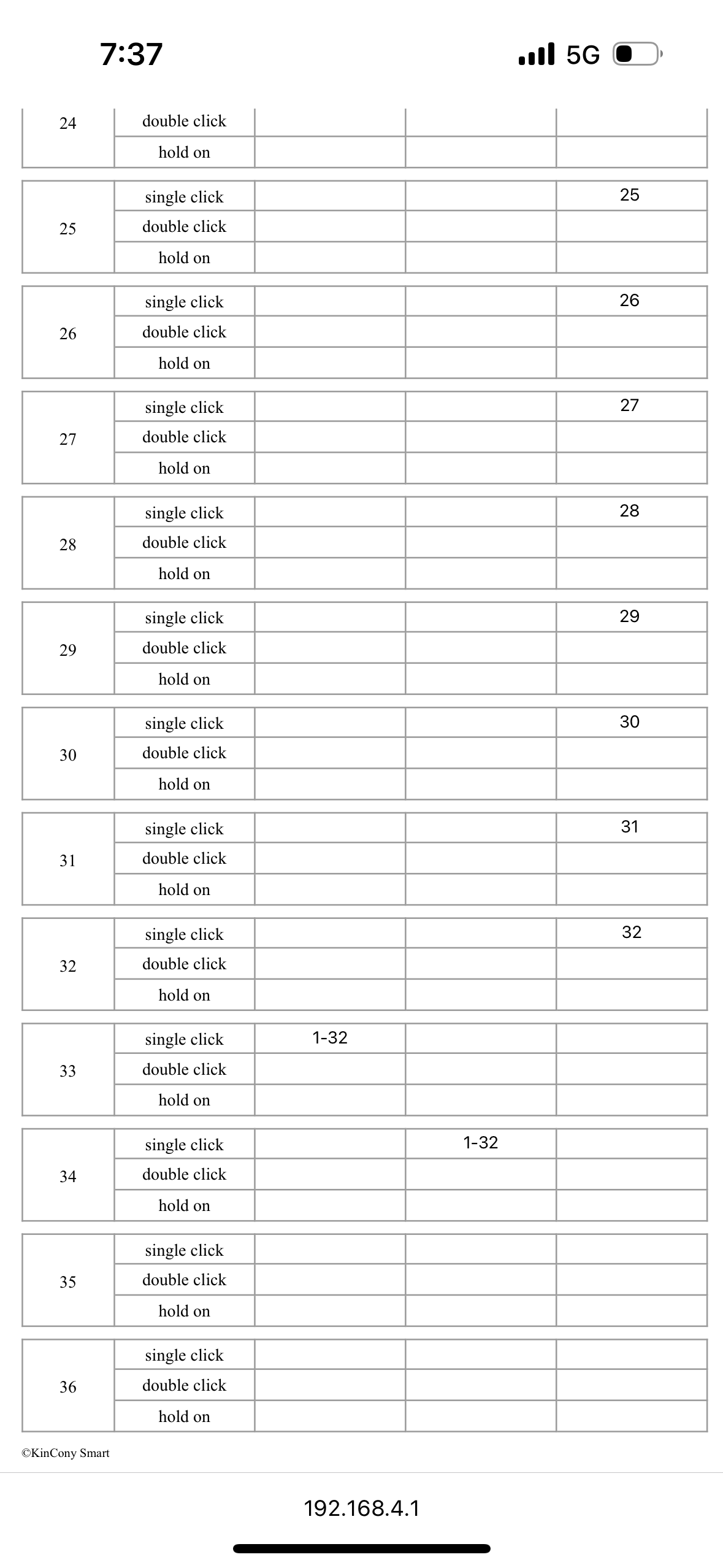

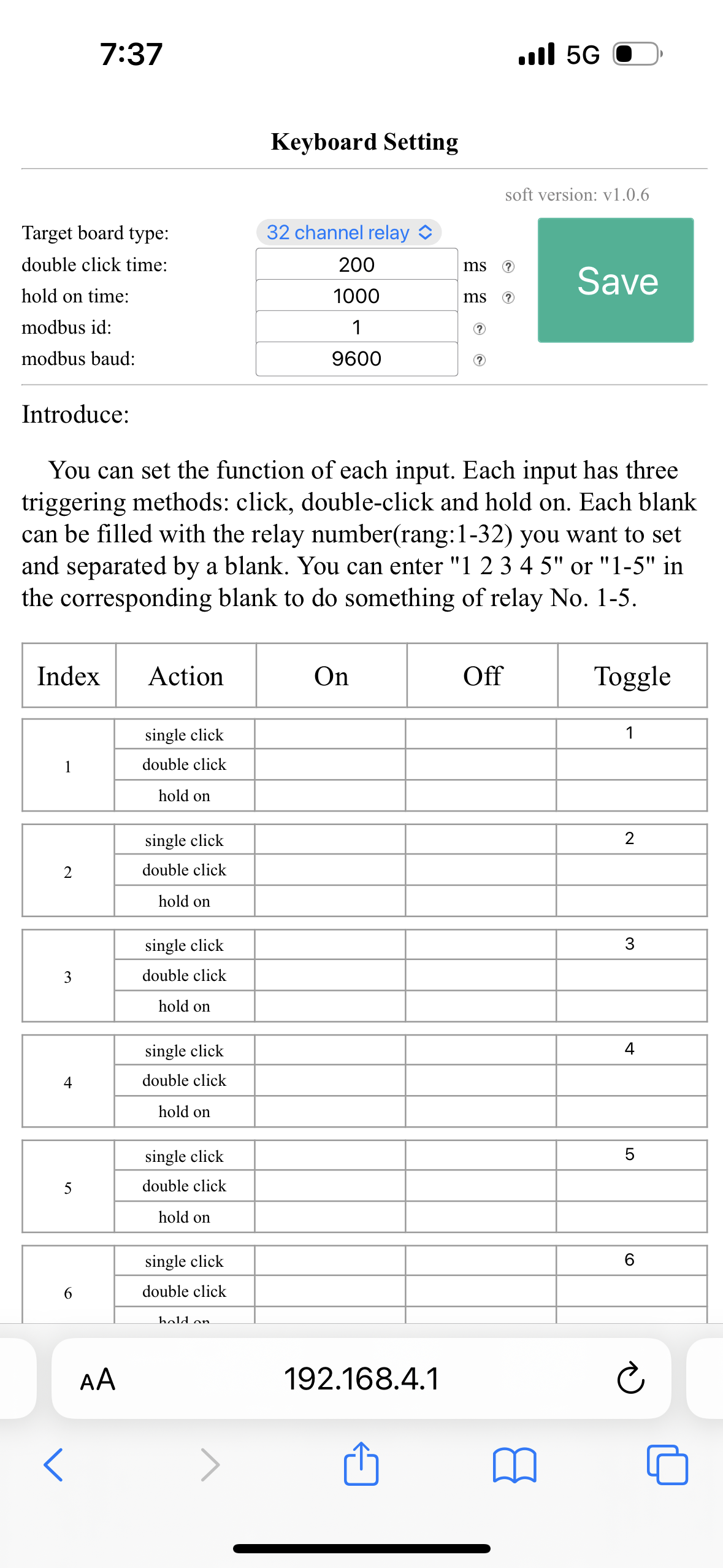

no, not to use "KCS", can you take a screen photo of your AK's setting and H32B Pro's setting.
RE: Schematic - safeermakar@gmail.com - 05-04-2023
Please find attached screenshots for both H32B pro and KC868-AK
