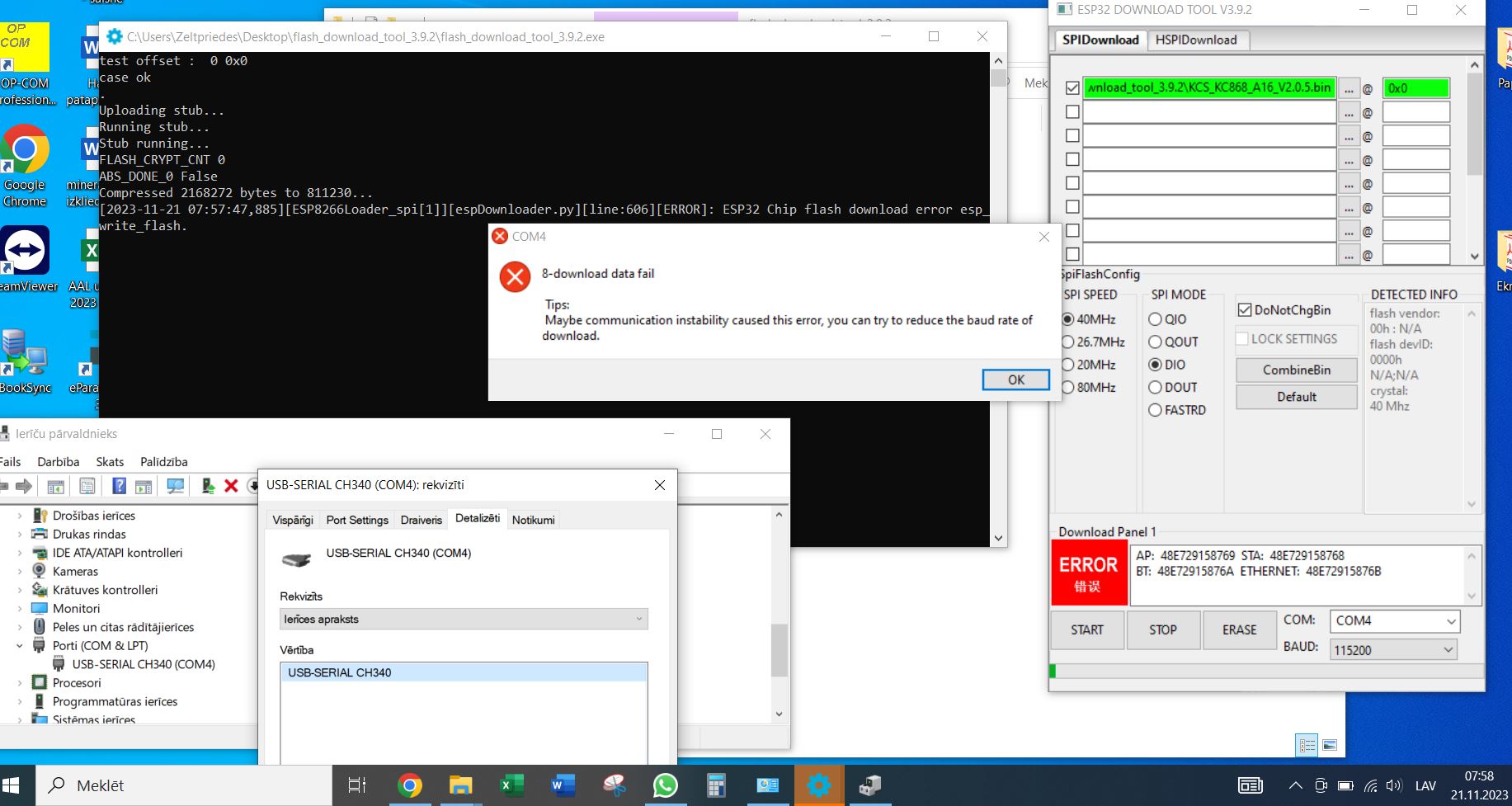

? take a screen photo of your error
RE: A16 flash problem - zeltini1401 - 11-20-2023
(11-20-2023, 10:46 AM)admin Wrote: ? take a screen photo of your error
RE: A16 flash problem - admin - 11-20-2023
do you have installed USB driver: https://www.kincony.com/download/CH341SER.zip
RE: A16 flash problem - zeltini1401 - 11-21-2023
(11-20-2023, 10:30 PM)admin Wrote: do you have installed USB driver: https://www.kincony.com/download/CH341SER.zip
RE: A16 flash problem - admin - 11-21-2023
change another USB cable, lower your baud rate of serial port.
make sure not use USB HUB with your computer, just use USB-C cable connect your board with PC directly.
(11-21-2023, 10:18 AM)admin Wrote: change another USB cable, lower your baud rate of serial port.
115200 speed is the lowest that can be selected. The cable is your original. Same thing with another wire. The wire is connected directly to the board, without any transitions. Is it possible to connect remotely? It will take you a few minutes to connect and adopt the settings like a pro.

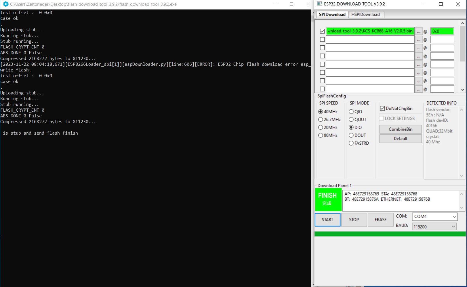

1. Do you have connected DC12v power supply for KC868-A16?
2. if you installed RF433M module, please remove it when download firmware.
take a photo of your board, how you wire.
RE: A16 flash problem - zeltini1401 - 11-22-2023
(11-21-2023, 11:46 PM)admin Wrote: 1. Do you have connected DC12v power supply for KC868-A16?
Good morning. After removing the RF modul, the program recorded. I'll try to record skits later.
RE: A16 flash problem - admin - 11-22-2023
it's ok now, just remove RF module when download.
