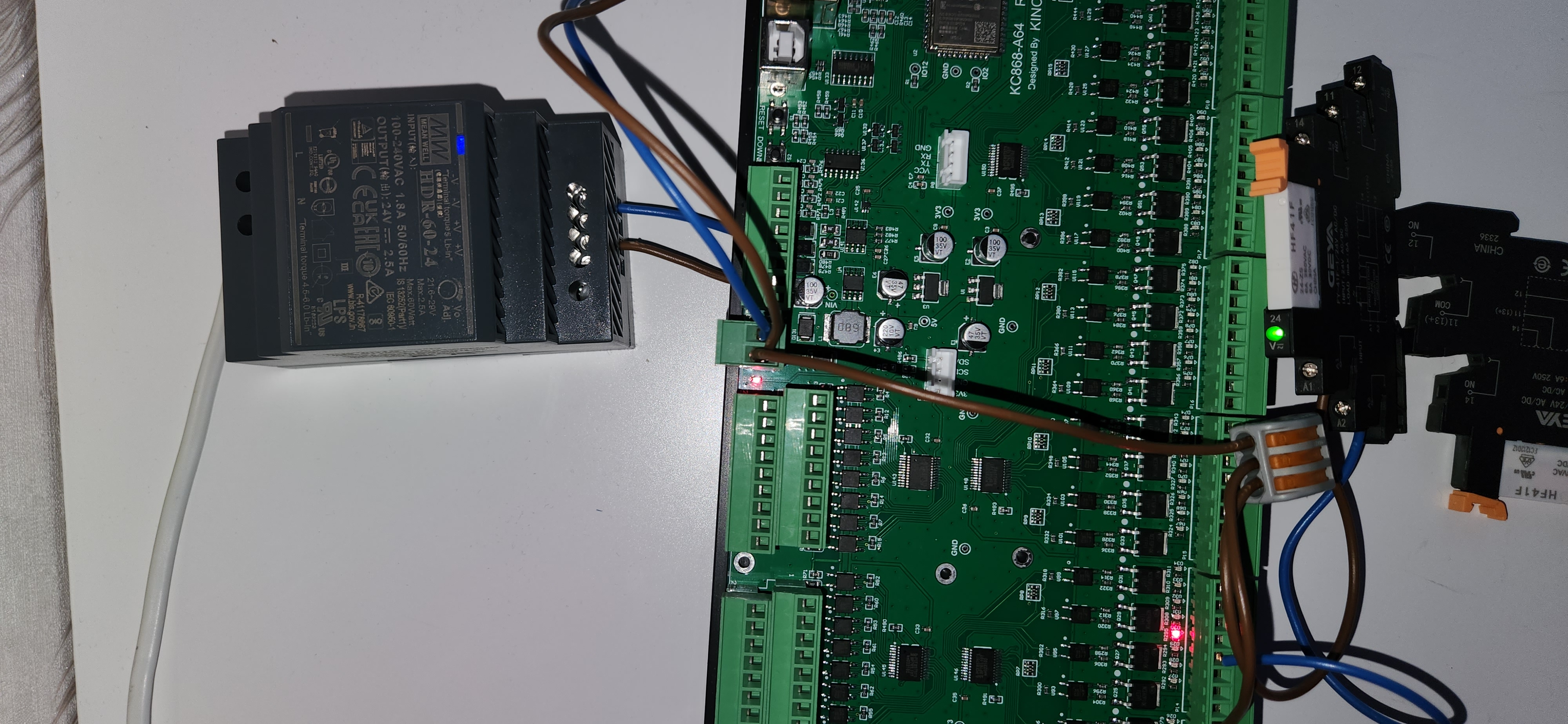

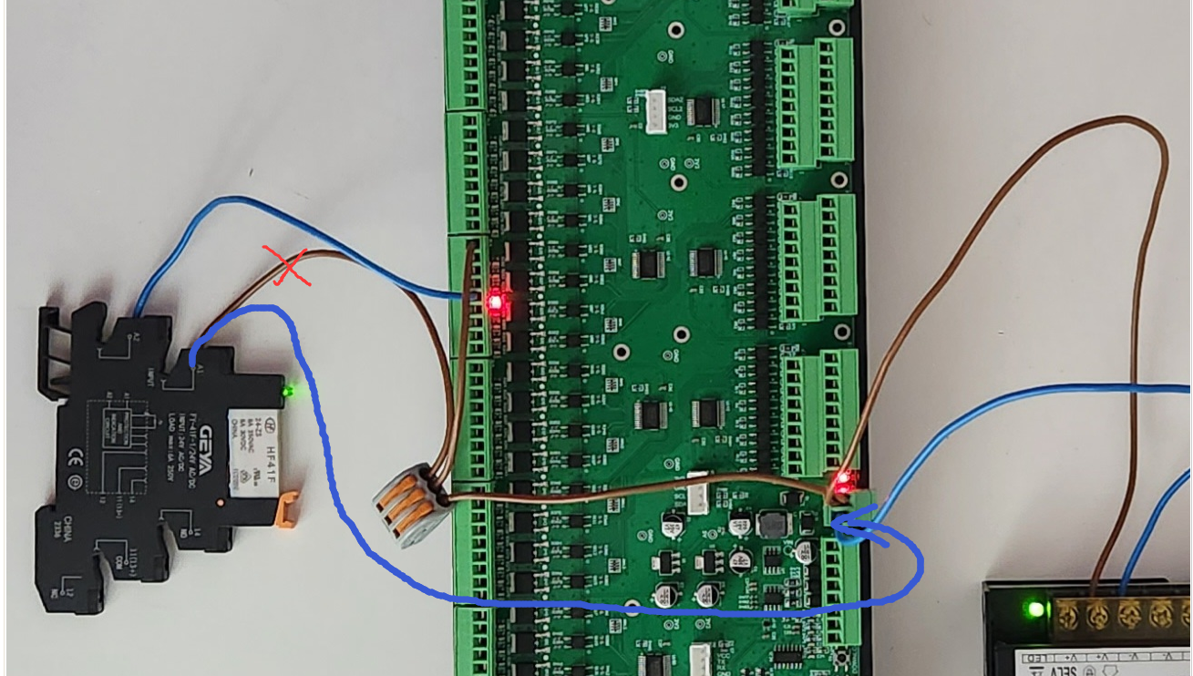

RE: Relay selection - igurgo - 10-08-2023 (10-08-2023, 09:27 AM)admin Wrote: can you change another power supply for a test? not use LED power supply. I bought power supply that support recommended. If it is connected to my circuit, then the indicators are as follows: The voltage of the digital output without load is 22.5V. When the relay is connected, the voltage is 8V. If you pull the SSR out of the relay, the voltage is 12.7V. Bad bad bad RE: Relay selection - admin - 10-08-2023 we will test with this SSR relay, then feedback to you. RE: Relay selection - igurgo - 10-09-2023 (10-08-2023, 02:18 PM)admin Wrote: we will test with this SSR relay, then feedback to you. Please, test with this one: https://aliexpress.ru/item/1005005623893857.html?click_id=9mTZ20xMq2ZB85O&af=2926_Y6Ljx9&cn=2urus29o033dd2buy78sku9ft8v4ktu6&cv=2&cv_source=default&dp=2urus29o033dd2buy78sku9ft8v4ktu6&utm_campaign=2926_Y6Ljx9&utm_content=2&utm_medium=cpa&utm_source=aerkol&aff_fcid=7a708fe539c148c5bdca05ad4c77e5d9-1696863171943-07576-_DD27gp1&aff_fsk=_DD27gp1&aff_platform=api-new-link-generate&sk=_DD27gp1&aff_trace_key=7a708fe539c148c5bdca05ad4c77e5d9-1696863171943-07576-_DD27gp1&terminal_id=45f4bd59666647f985b6b40395154aed RE: Relay selection - admin - 10-09-2023 yes, we already bought this relay, wait it arrived, will test it. RE: Relay selection - igurgo - 10-10-2023 (10-09-2023, 10:39 PM)admin Wrote: yes, we already bought this relay, wait it arrived, will test it. I'm sure there's nothing wrong with your development, I just received a non-working device. I simply don’t have the space for another arrangement of devices. When will you receive the parcel? Dispute on aliexpress until October 13. RE: Relay selection - admin - 10-10-2023 today will receive relay sample for testing. RE: Relay selection - admin - 10-11-2023 A64 board is no problem, your relay wire wrong. the coin wire it should connect to GND, see this photo. RE: Relay selection - igurgo - 10-11-2023 (10-11-2023, 12:51 AM)admin Wrote: A64 board is no problem, your relay wire wrong. the coin wire it should connect to GND, see this photo. Yes. Everything is fine now. Thanks! RE: Relay selection - admin - 10-11-2023 ok, good |
