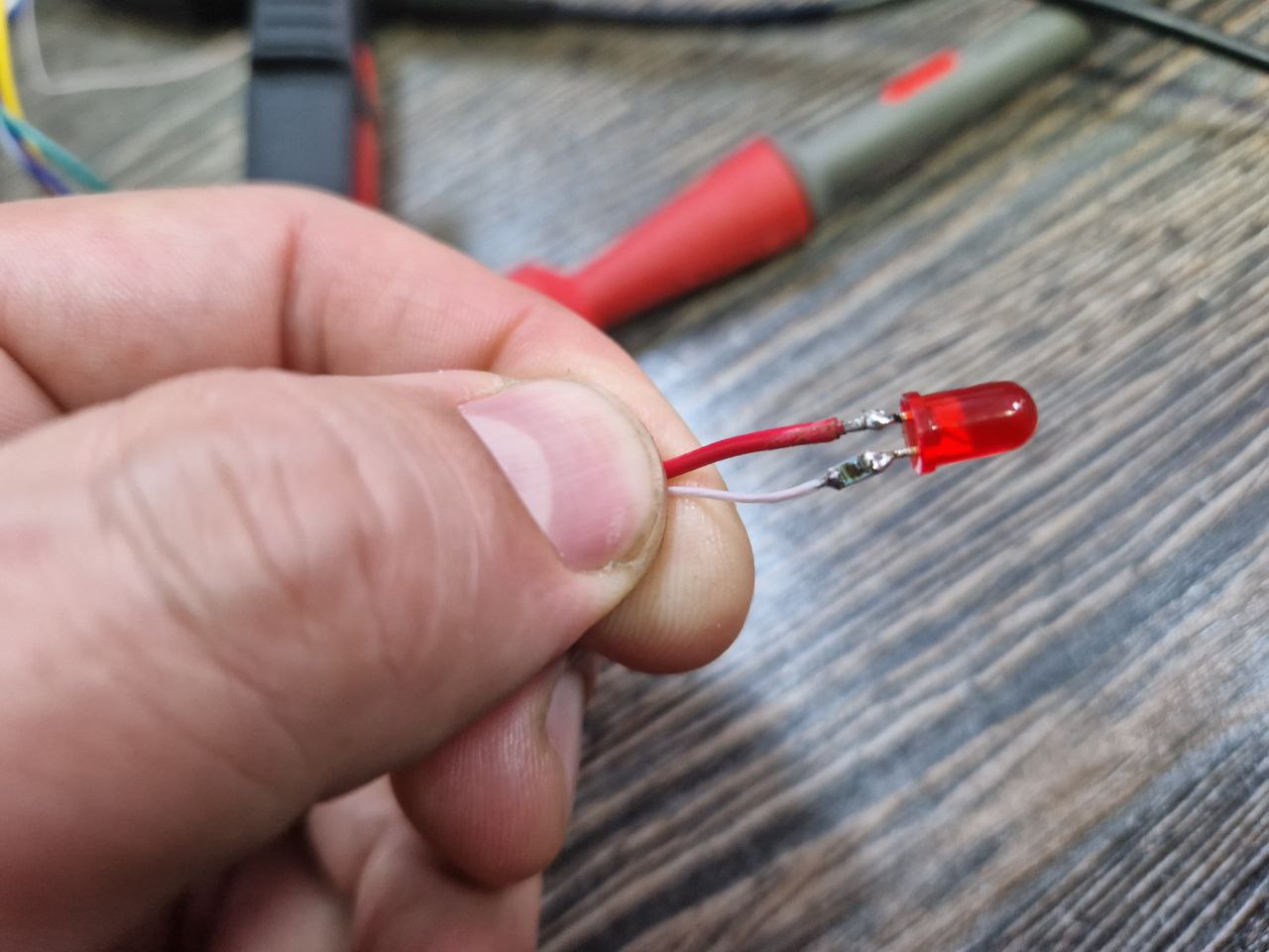

I connected it like this. Right?

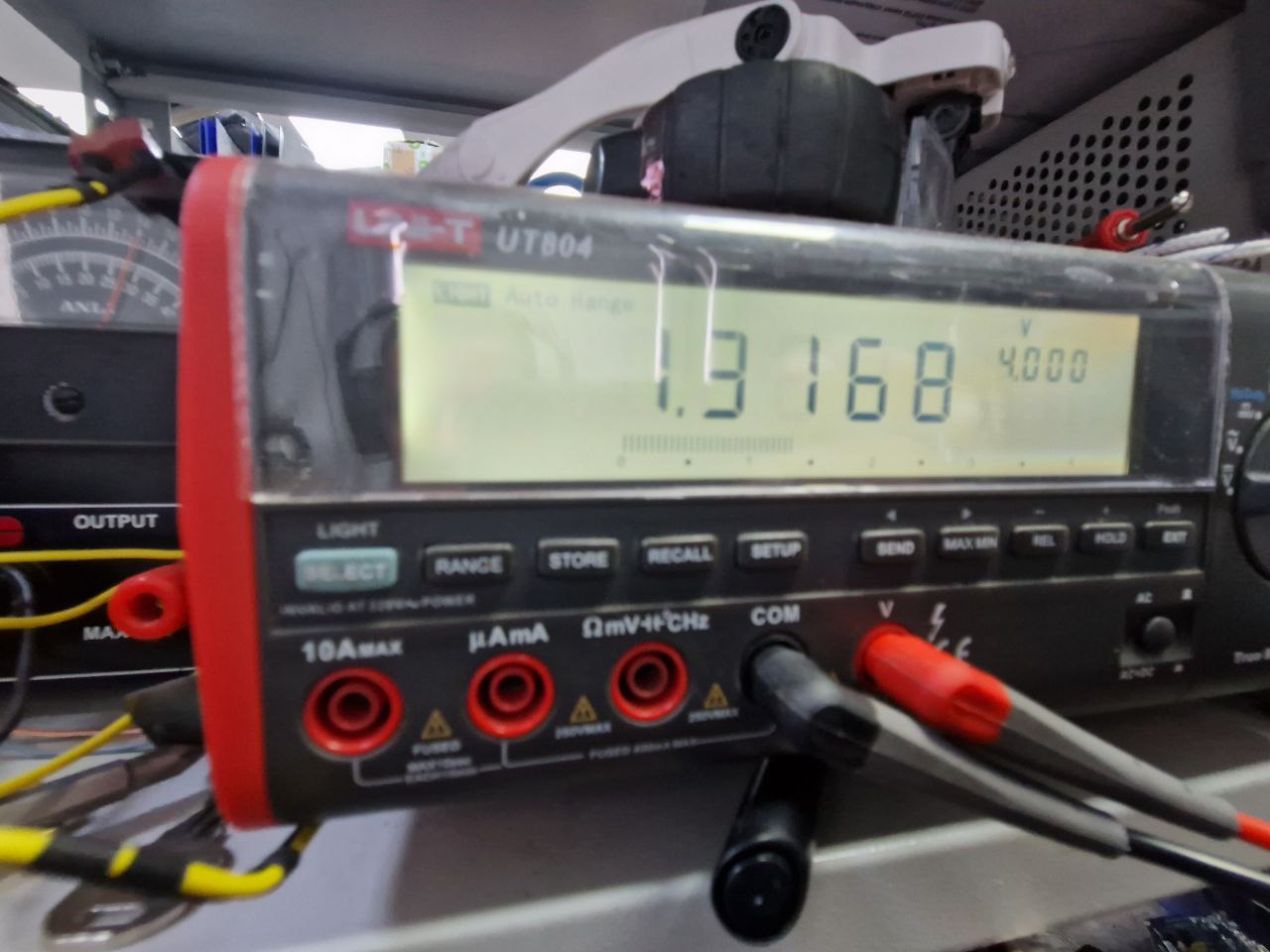

I measured the voltage relative to the positive supply. All outputs are about 1.2 volts, no change regardless of the command.
RE: KC868-HA RS485 INPUT & OUTPUT plugin for ESPHome - admin - 11-03-2023
if you connect LED with dc12v directly, you need to connect a current limiting resistor in series, if without resistor, i think the LED is bad now.
RE: KC868-HA RS485 INPUT & OUTPUT plugin for ESPHome - Kataktok - 11-03-2023
Of course I connected a resistor, but there is no output from the board, what should I do?
when turn ON switch, Dx output about 0-1v is correctly. when turn OFF, it should be about 5v with Dx output terminal.
you can compare the level when you turn ON/OFF.
do you have another KC868-HA PCB? or only have one?

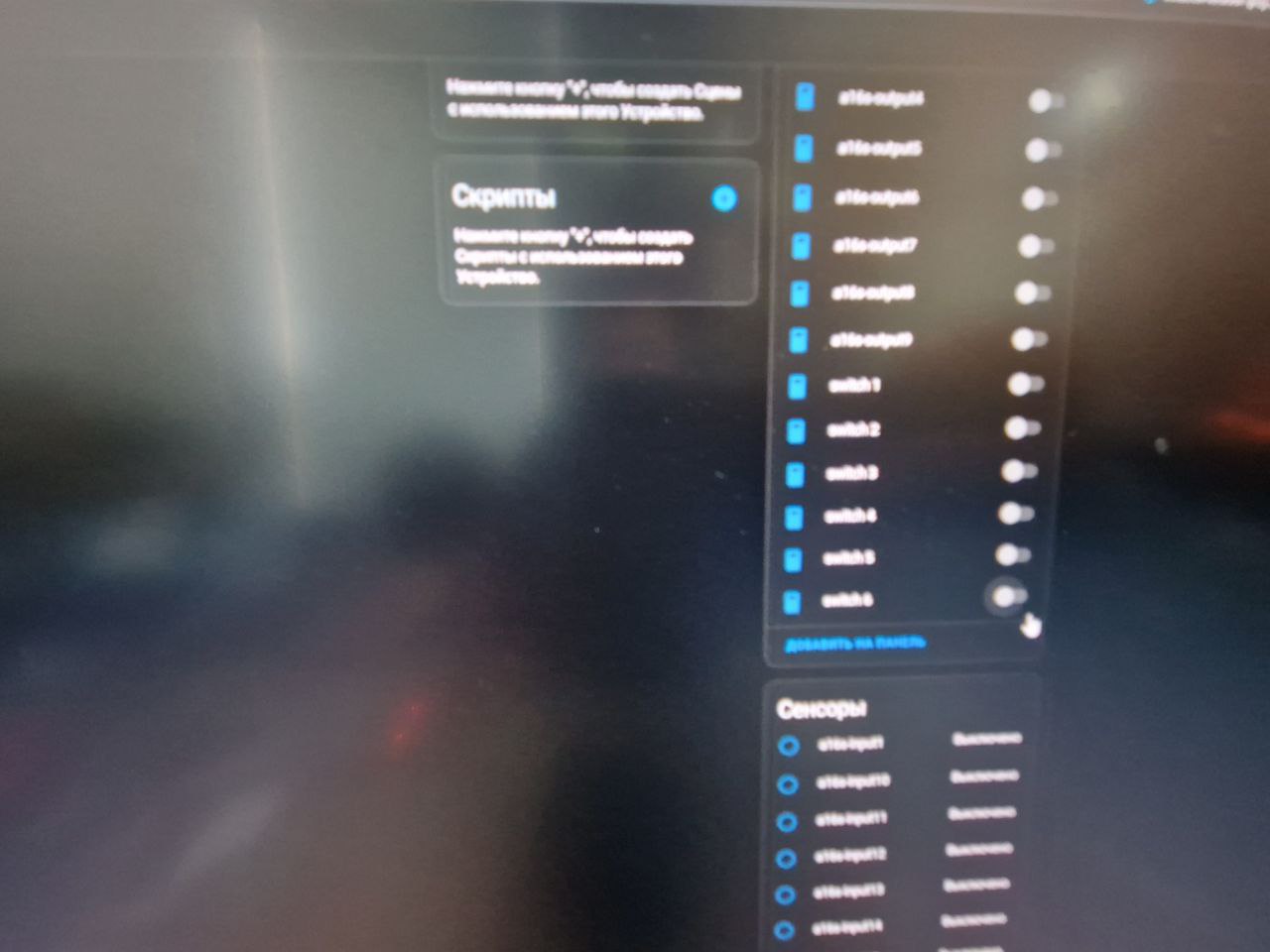

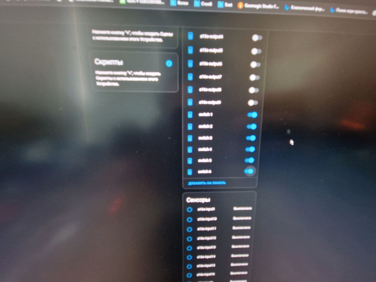

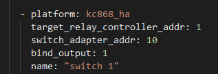

When I press the buttons, these get correctly triggered in Home Assistant. But, if I try toggling on the switches in Home Assistant which should trigger the outputs of the KC868-HAv2 to turn on one of the LEDs in the switch, it doesnt work. But I can see in the ESPhome logs it sends the RS485 message.
I am running the latest ESPhome, the latest KC868-HA component (v3.0.0) and the latest firmware on the KC868-HAv2 (v200).

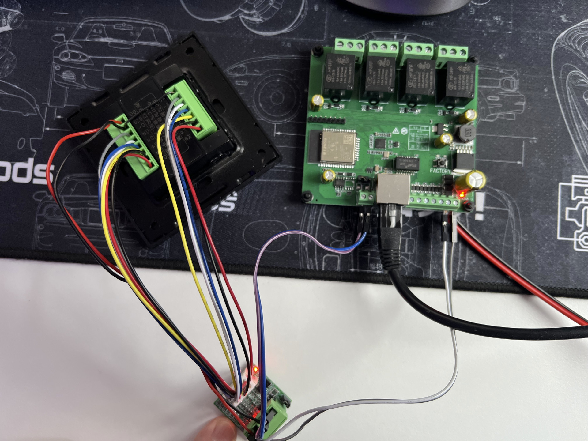

RE: KC868-HA RS485 INPUT & OUTPUT plugin for ESPHome - gizmo - 12-16-2023
(12-16-2023, 01:17 PM)admin Wrote: take a photo how you wire, which switch panel you are using.
Please see the wiring in the photos.
I am using this switch panel: Kincony KC-LNW-306 according to the listing.
Here is the link to the listing i bought: https://www.aliexpress.com/item/32998595147.html?spm=a2g0o.order_list.order_list_main.10.3f1f18028oT7RJ
Thank you
RE: KC868-HA RS485 INPUT & OUTPUT plugin for ESPHome - admin - 12-17-2023
becasue the BLACK switch LED ON when voltage = 0v or GND.
so you can test swtich panel firstly, not need HAv2 (remove HAv2), just short any pin D1-D6 with GND, check whether BUTTON's LED ON?
RE: KC868-HA RS485 INPUT & OUTPUT plugin for ESPHome - gizmo - 12-17-2023
(12-17-2023, 01:22 AM)admin Wrote: becasue the BLACK switch LED ON when voltage = 0v or GND.
The switch LEDs work fine if i bridge GND and D1-D6.
But the HAv2 doesnt turn them on even when the "switch" is turned on from HA
RE: KC868-HA RS485 INPUT & OUTPUT plugin for ESPHome - admin - 12-18-2023
use mulit meter test HAv2 OUTPUT1-6 when voltage will change if your turn ON/OFF on home assistant.
