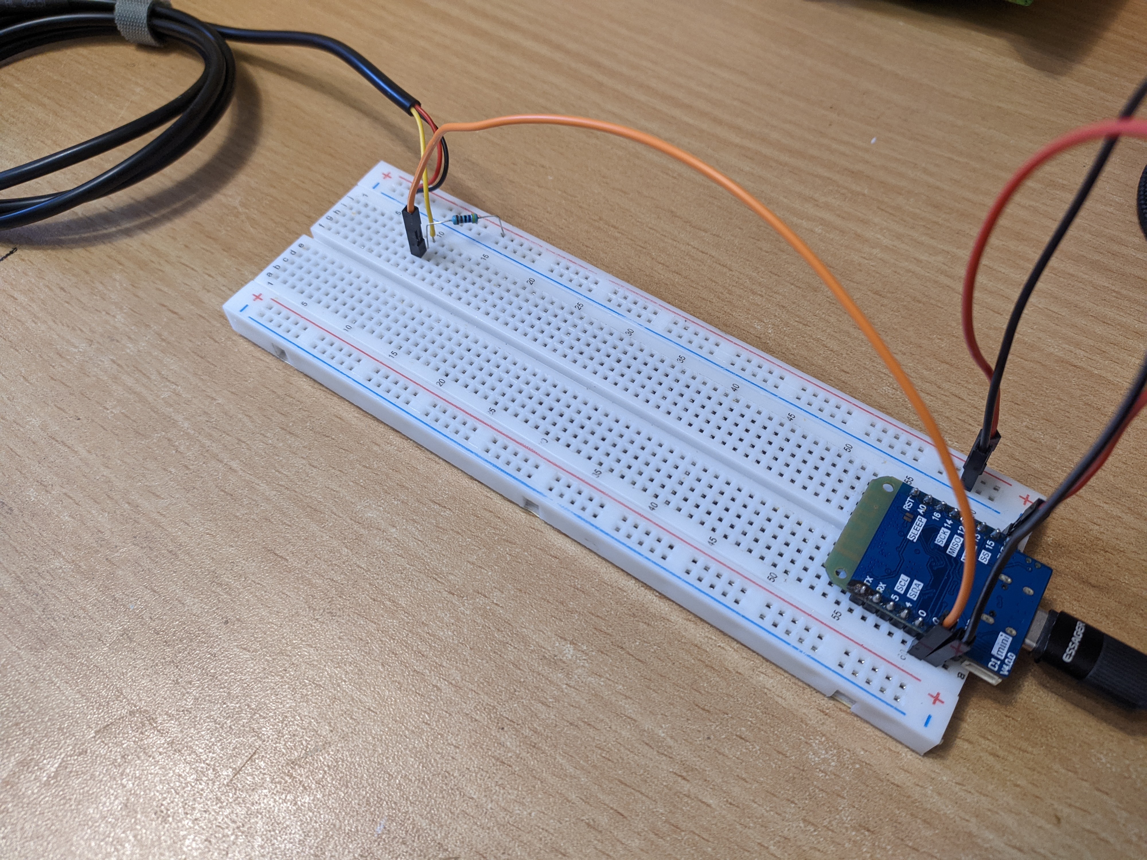

I connected a new sensor with a 1-meter wire. I tested the sensor for over 1 hour and still see the warning in the logs...

I tested this sensor with the D1 mini board using a 4K7 pull-up resistor. More than 1 hour passed and I did not receive any warning in the logs.

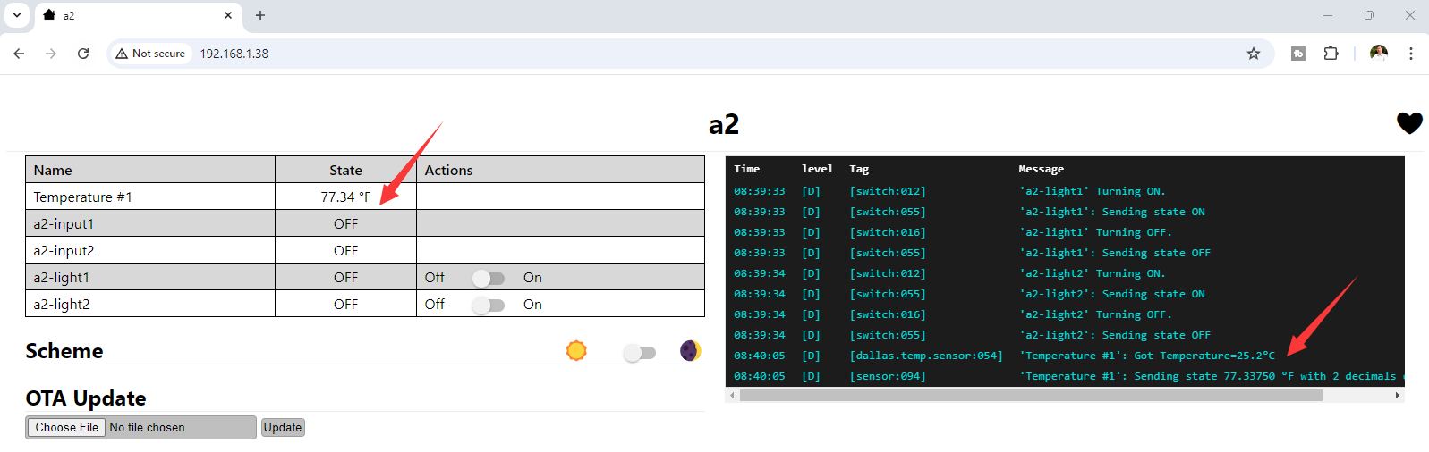

I have tested KC868-A2 board with GPIO33 for DS18B20
here is webpage:
here is my ESPHome config file:
you can test with my yaml file (just replace DS18B20 sensor ID by yourself):

Perhaps you misunderstood me. I receive data from the sensor, but from time to time the sensor sends a warning in the logs “Scratch pad checksum invalid!” and the connection with it is lost for one sensor update interval (in my case, 5 seconds). This can happen either 3-5 minutes after launching or 15-20 minutes later, there is no regularity. To make sure that everything is fine, you need to connect the detector and leave the log for 1 hour, and then check if everything is fine. But the fact that these warnings appear in the logs must mean something. As I mentioned above, I don't get these warnings on my other D1 Mini board.
Your example didn't work either. Could something on the A2 board be damaged and affect the warnings from the DS18B20 sensor?
