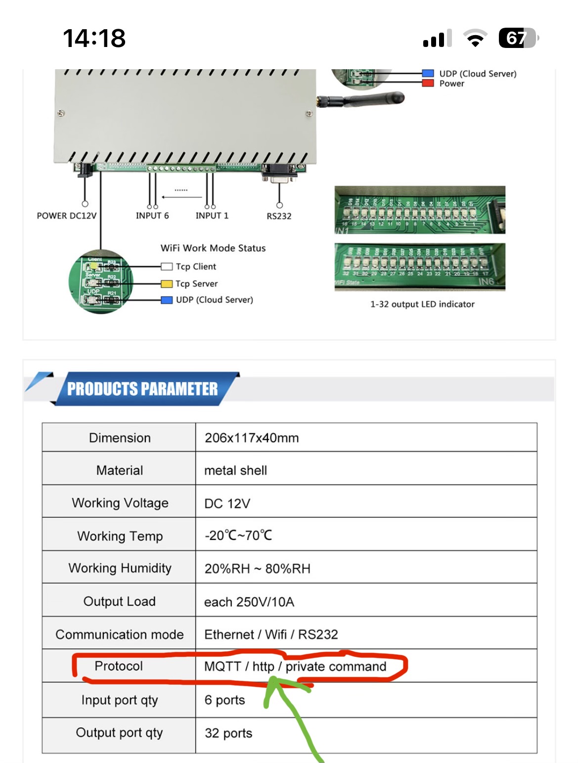

Does h32b support http command?
RE: Http protocol - admin - 04-18-2026
yes, H32B support HTTP protocol, here is protocol document: https://www.kincony.com/download/KC868-H32B-http-command.pdf
