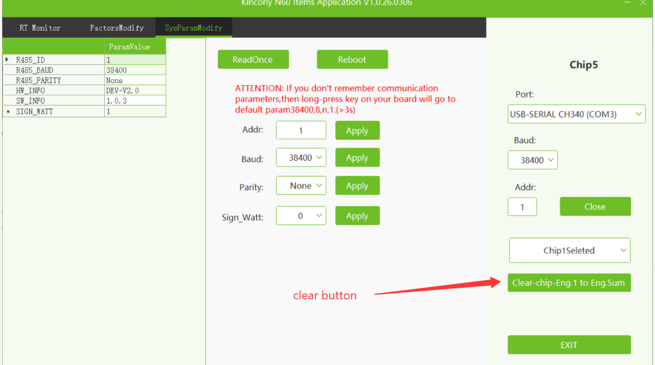

you can use N60 PC software, there is CLEAR button. it will send command by RS485. then you add USB-RS485 adapter, when you click button, will see what command have sent, just copy this command for your ESPHome clear button's command.
pc software download: https://www.kincony.com/forum/attachment.php?aid=9282

I sniffed the traffic from the App to see this for resetting chip 1's data:
01 05 02 08 ff 00 0c 40
Which decodes to running a 0x05 operation on 520 with a value of 1. I am able to replicate this exact operation with this esphome switch:

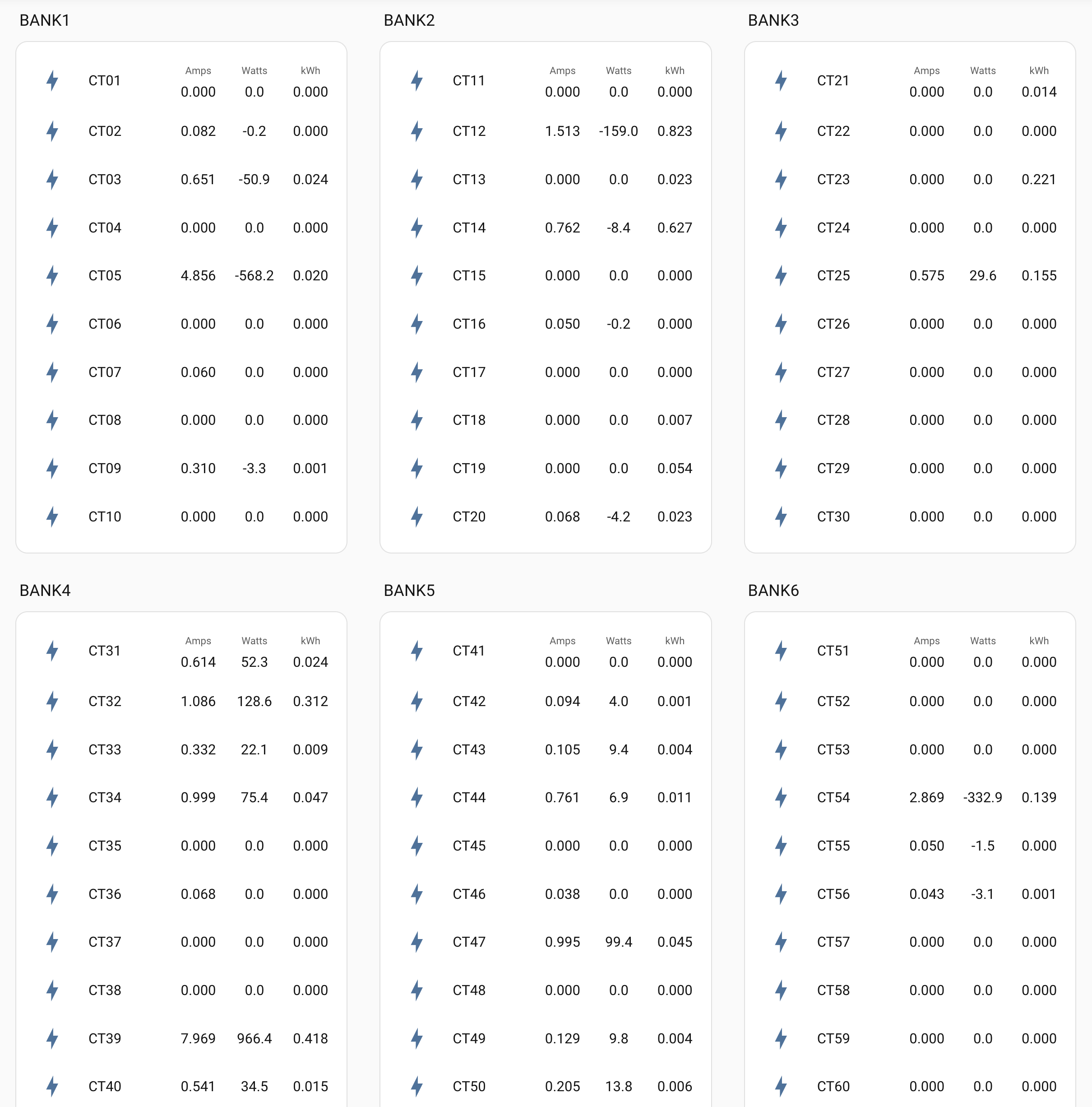

With that mystery solved, what would cause watts to be reported negative? (NONE of the ct's are on devices which generate power. All of the CT's are installed in the exact same orientation (which side faces the breaker/source). It's possible that I've flipped some red/black wires on the pos/neg inputs on the CT pins, but..for this many?
Well, I guess this works:
Additional configuration register:
- Register 30: Bidirectional CT mode (0x03 read, 0x06 write)
  - 0: Disabled
  - 1: Enabled
Turned that off... which "fixes" the problem, technically, but I feel like if I have it all wired up correctly I shouldn't be seeing negative watts.
Still want to fix it the "right" way.
