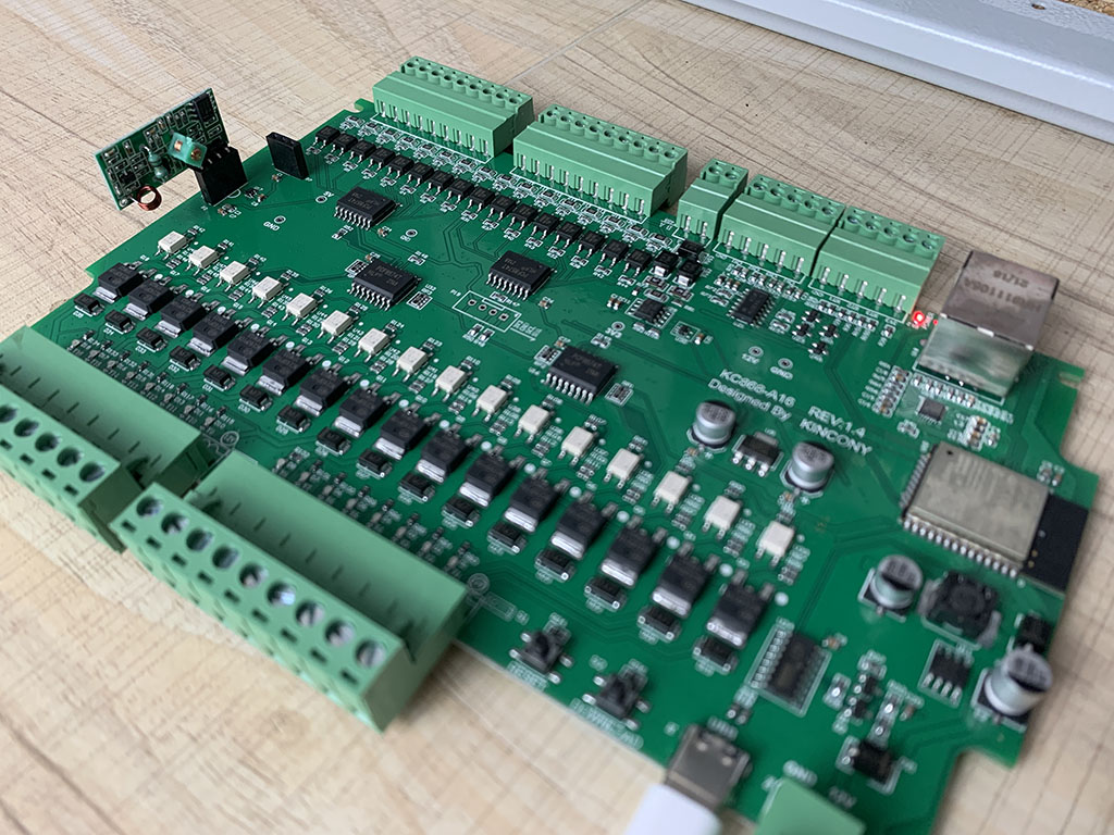

RE: K868-A16 433 RF MHz receiver - Razvan - 03-29-2022
Today I installed the new 433 Mhz RF reception and transmission modules. Unfortunately the same result, I can not see any code in the log inside K868-A16 with ESPHome.
I also took measurements. When I do not press any button on the remote control, the voltage is almost 0.014 V. When I press any button on the remote control, the voltage remains the same, it does not change.
I think there's something wrong with this board. It's hard for me to believe that the new RF module is also defective.

I have attached some pictures.

RE: K868-A16 433 RF MHz receiver - admin - 04-02-2022
you can use my config file, have test.
.txt   A16-config-HA-RF-decode.txt (Size: 522 bytes / Downloads: 854)
i think you can try to weld a 10K resistance between RF 433M Hz receiver module "DATA" and "GND" pins.
RE: K868-A16 433 RF MHz receiver - Razvan - 04-04-2022
I tried your configuration and the same result, does not work.
I also tried wifi instead of LAN and it still doesn't work.
On the back of the pcb is already a factory weld resistor. I measured it and it has 9.98 K.(like in your picture)
I also bought an oscilloscope. Can you tell me what and where to measure so we can see if this board is defective or not?
