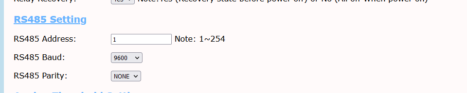

if your KC868-Server RS485 address is "1" and "9600bps" have set. You can send these commands by serial port to test whether output1 is ON or OFF.

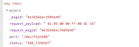

RE: Read Serial (RS485) Data - v1rtus - 06-16-2022
Unfortunately it did not work even with USB -> RS485 adapter.
Server RS485 settings.
Any ideas?

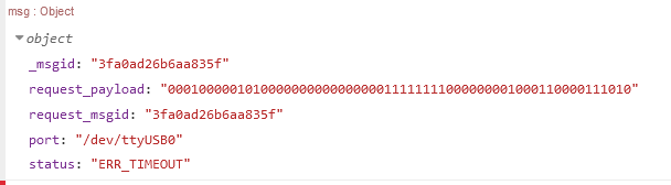

I converted hex to binary: 01 05 00 00 FF 00 8C 3A -> 000100000101000000000000000011111111000000001000110000111010 but unfortunately nothing changed, the error is same.

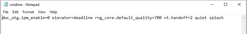

I finally managed to make internal RS485 (orange) working.
OS: Ubuntu Core 20.04.4 LTS
Steps:
  1. Open cmdline.txt
  2. Remove console=serial0,115200
  3. Reboot
I am running node-red in docker so I had to also map /dev/ttyS0 as device and give read/write permissions.
