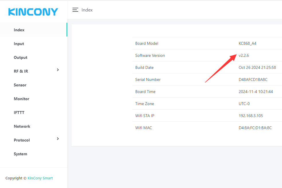

I Think your code looks correct, My KC868-A4 gives a similar problem;
When publishing a MQTT message with KC868_A4/XXXXXXXX/SET
The relay(s) respond to the output commands output1:{"value":true}
the dac(s) do not respond to the dac1:{"value":158} or any other value
Firmware in use : KCS_KC868_A4_V2.2.6.bin

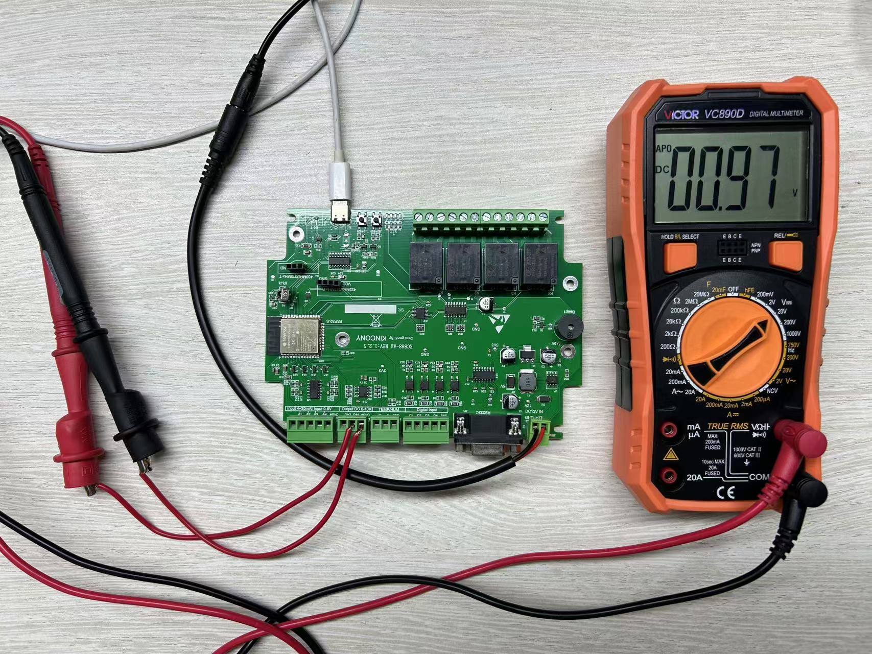

RE: KCS firmware - MQTT LWT? - admin - 11-04-2024
i have tested send command control DAC , it's OK.
please send command as our protocol. where you have seen the protocol document let you send ALL data (copy by STATE result) to controller???
