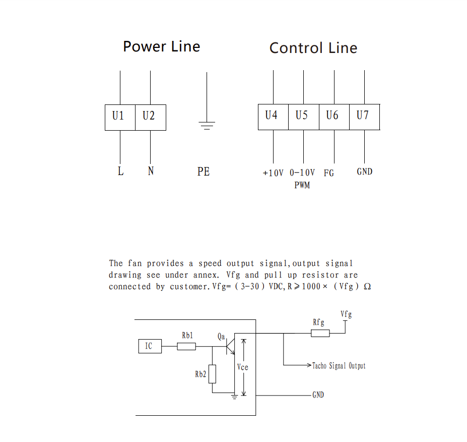

I connect the tachometer wire from the fan to the digital input on the A2 board. The wiring diagram is attached. I have connected the FG wire to the digital input and the GND from the fan is connected to another device that shares a common power supply with the A2 board, so all GNDs are connected to each other. I know that there are pull-up resistors on the A2 board, which are needed to read the fan RPM.
I connected and checked the operation, and everything was fine. But lately I noticed that the RPM readout is working with problems, sometimes it shows 0 RPM, although the fan is working properly, sometimes it shows 50-150K, although the maximum fan RPM is 3200, the fan is working in normal mode at this time. I can't figure out what's wrong.

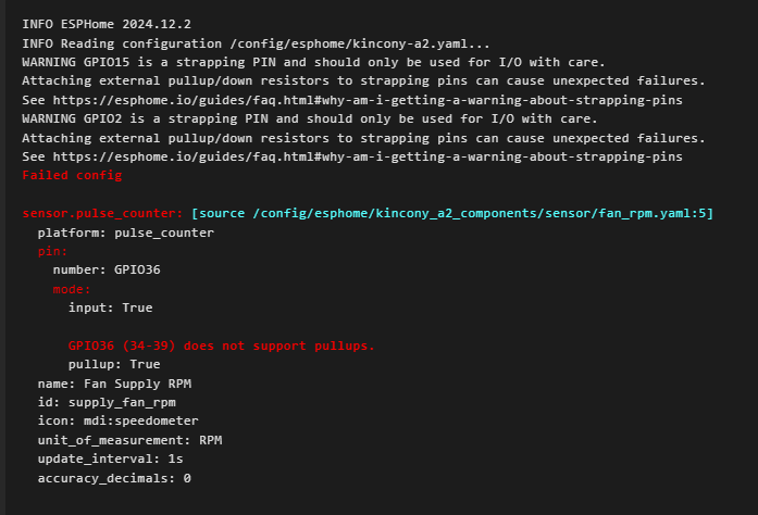

Also in the yaml code it was written like this:
  - platform: pulse_counter
    pin:
      number: GPIO36
    name: “Fan Supply RPM”
    icon: mdi:speedometer
    unit_of_measurement: “RPM”
    update_interval: 1s
    accuracy_decimals: 0
    filters:
      - multiply: 0.5
      - exponential_moving_average:
          send_every: 5
but when I tried to add it, I got an error.
mode:
      input: true
      pullup: true
What can it be, what is the problem? Does the pullup resistor work and why can't I write it in the code?
RE: SHT30/DS18B20 errors and warnings in the logs - admin - 01-11-2025
remove " pullup: true" , LOG showed not support that.
RE: SHT30/DS18B20 errors and warnings in the logs - TaurosRMK - 01-16-2025
(01-11-2025, 01:57 AM)admin Wrote: remove "      pullup: true" , LOG showed not support that.
Are you serious? I think the question was about something else, is the pull-up resistor working here, given that it is impossible to activate it in the code, because these pins do not support pull-up resistors?
And could this be the reason why the RPM is sometimes not read, even though the fan is working properly? Or the RPMs are read, but instead of the maximum 3200 RPMs, 30-50-100K RPMs are read.

So... If looking at the fan wiring diagram (post above), how do I connect the wires to the A2 board to read the RPM from the fan?
