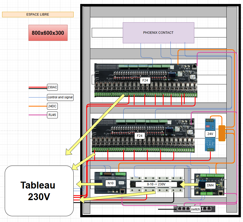

RE: ⚡ 40 Buttons, 36 Lighting Circuits & Home Assistant — How Would You Build It? - lulu01 - 09-07-2026 If you have a single phase system, yes the Kincony N10 and the CT transformers will do the job. You can extend the cable, you will just need to solder. The 1.5mm2 should be good for lighting. I *think* 0.5 mm2 will be ok for the rest, but I would check with the electrician. RE: ⚡ 40 Buttons, 36 Lighting Circuits & Home Assistant — How Would You Build It? - viko - 09-07-2026 Yes, thanks. I'll definitely get that confirmed! Just so you know, I've decided to go with the TP-Link Omada system instead of UniFi after all. Thanks again for the advice! RE: ⚡ 40 Buttons, 36 Lighting Circuits & Home Assistant — How Would You Build It? - viko - 09-09-2026 Hi everyone,
Please note that the cables are not precisely placed on their actual connection terminals. The wiring shown is only a rough representation of the different voltages and cable types. Cheers! RE: ⚡ 40 Buttons, 36 Lighting Circuits & Home Assistant — How Would You Build It? - viko - 11-01-2026 Hello, Just a quick note to provide an update. Everything isn't fully sorted out yet, but I’ve managed to install my cabinet and the modules—I’ve attached a photo. I ran an initial test today using a light bulb and a switch. Now, I’m going to get started on the configuration via ESPHome. Have a great Sunday! RE: ⚡ 40 Buttons, 36 Lighting Circuits & Home Assistant — How Would You Build It? - lulu01 - 11-03-2026 Nice start and tidy cabling (so far at least ) - I'll be happy to see more pictures as you progress
