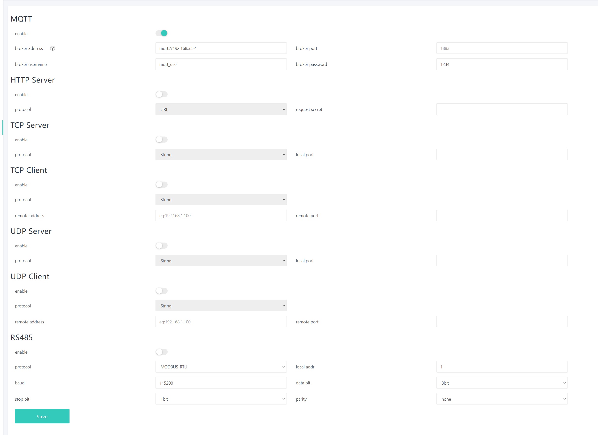

Only thing enabled is MQTT
RE: "KCS" v1.0.24 firmware BIN file download - admin - 05-31-2024
can you disable MQTT for a testing.
RE: "KCS" v1.0.24 firmware BIN file download - Philadam - 05-31-2024
Disabled MQTT and got the same results.
