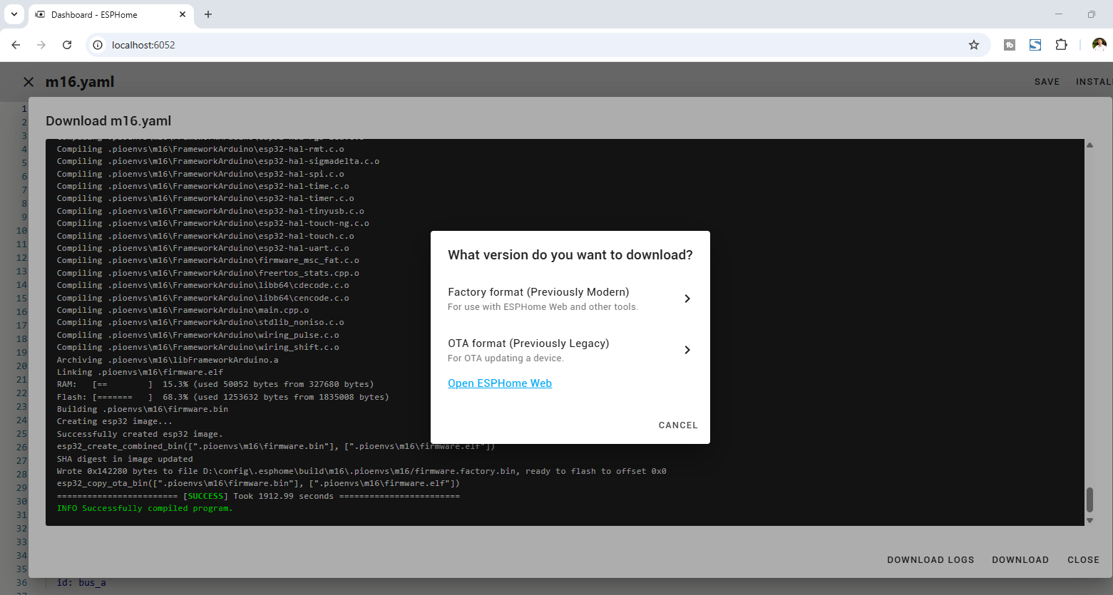

RE: KC868-M16v2 configure yaml for ESPhome - admin - 08-16-2025
have tested with ESPHome: 2025.7.5
.txt   M16v2-HA.txt (Size: 9.26 KB / Downloads: 383)

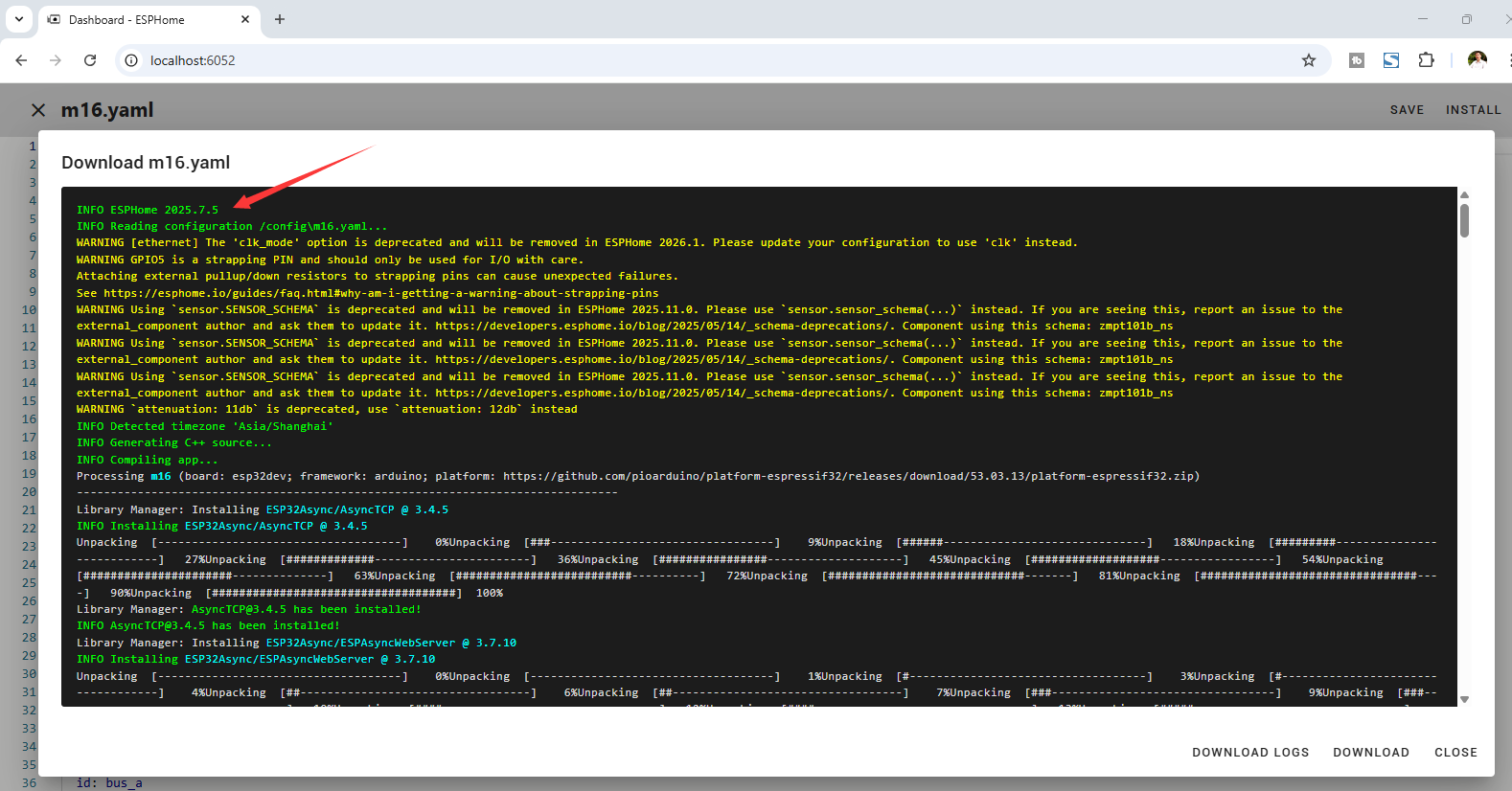

my computer only have one ESPHome version: INFO ESPHome 2025.7.5
see photo.

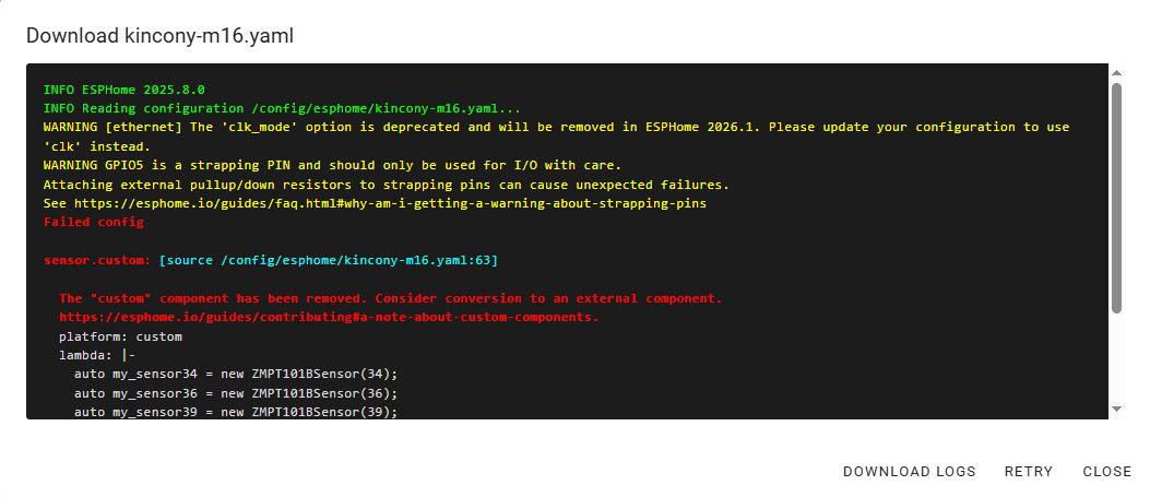

RE: KC868-M16v2 configure yaml for ESPhome - cignu - 08-24-2025
I'm setting up my M16V2
I get this error in ESPHome Device Builder and can't upload the yaml file
Do you have any suggestion?
