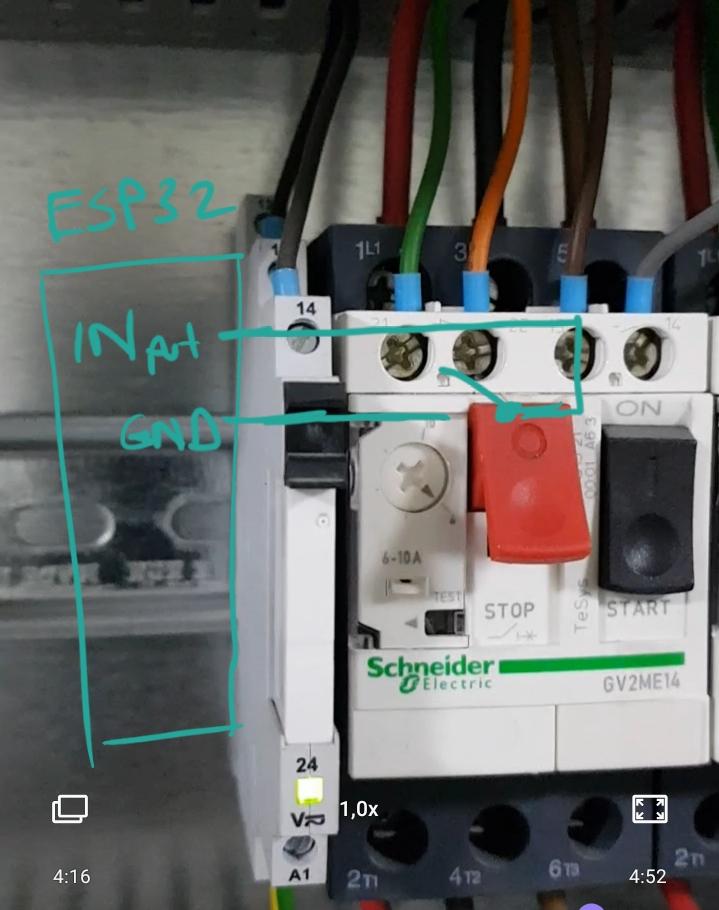

ESP32 input problem from contacts of Thermal-magnetic circuit breaker - gokhan - 12-30-2021 Hi I am designing a pressure controlled vacuum tank. Software of ESP32 and Nextion screen is OK But I have problem when I get digital input from (TMCB) thermal magnetic circuit protector( schneider gv2me14) When red fault contacts close I want to get information of fault of motor. But esp32 reset itself . RE: ESP32 input problem from contacts of Thermal-magnetic circuit breaker - admin - 12-30-2021 do you have connect the detect signal port to ESP32's GPIO directly? Is there an optocoupler isolation circuit? RE: ESP32 input problem from contacts of Thermal-magnetic circuit breaker - gokhan - 01-01-2022 No I don't use optocoupler Would you advise optocoupler module or any other product ? RE: ESP32 input problem from contacts of Thermal-magnetic circuit breaker - admin - 01-01-2022 maybe your contactor have interference signal. |
