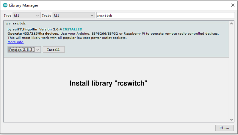

Code 2: //The demo code is 433Mhz receive code   You can copy the code to your Arduino IDE
#include <RCSwitch.h>
void setup() {
  Serial.begin(9600);
  mySwitch.enableReceive(digitalPinToInterrupt(13));// IO13  433 RECEIVE PIN
void loop() {
  if (mySwitch.available()) {
    Serial.print("Received ");
    Serial.print(" / ");
    Serial.print("bit ");
    Serial.print("Protocol: ");
    mySwitch.resetAvailable();
.zip   RF-receiver.zip (Size: 393 bytes / Downloads: 975)
