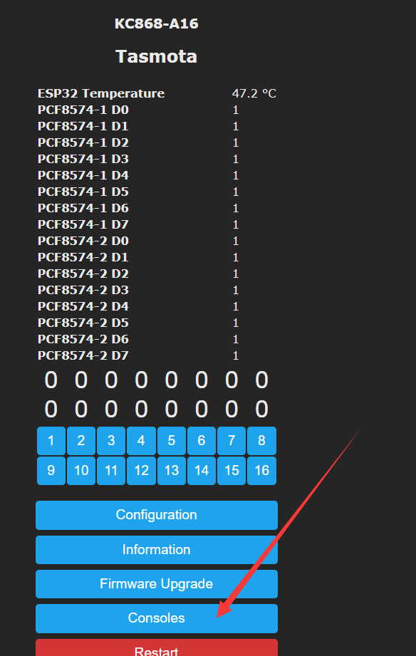

here are setting photos for sample rule1:

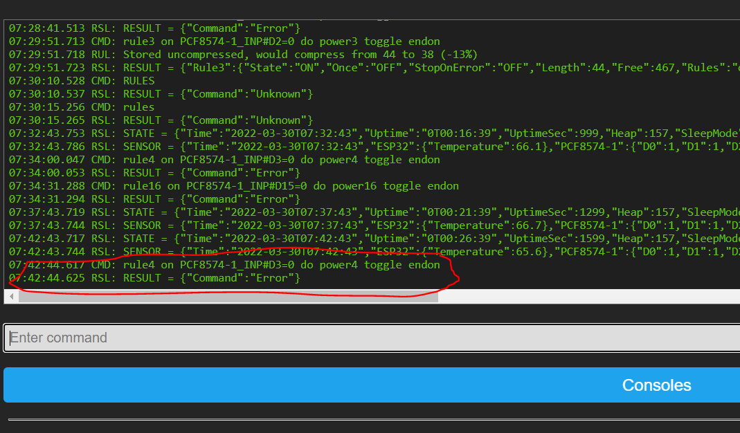

I'm getting a command error when adding additional rules e.g.
rule4 on PCF8574-1_INP#D3=0 do power4 toggle endon
rule4 1

RE: KC868-A16 "input1 toggle output1" automation rules in Tasmota - admin - 03-30-2022
Rule1
on PCF8574-1_INP#D0=0 do power1 toggle endon
on PCF8574-1_INP#D1=0 do power2 toggle endon
on PCF8574-1_INP#D2=0 do power3 toggle endon
on PCF8574-1_INP#D4=0 do power5 toggle endon
on PCF8574-1_INP#D5=0 do power6 toggle endon
on PCF8574-1_INP#D6=0 do power7 toggle endon
on PCF8574-1_INP#D7=0 do power8 toggle endon
on PCF8574-2_INP#D0=0 do power9 toggle endon
on PCF8574-2_INP#D1=0 do power10 toggle endon
on PCF8574-2_INP#D2=0 do power11 toggle endon
on PCF8574-2_INP#D3=0 do power12 toggle endon
on PCF8574-2_INP#D4=0 do power13 toggle endon
on PCF8574-2_INP#D5=0 do power14 toggle endon
on PCF8574-2_INP#D6=0 do power15 toggle endon
on PCF8574-2_INP#D7=0 do power16 toggle endon
use one rule1 will be ok.
