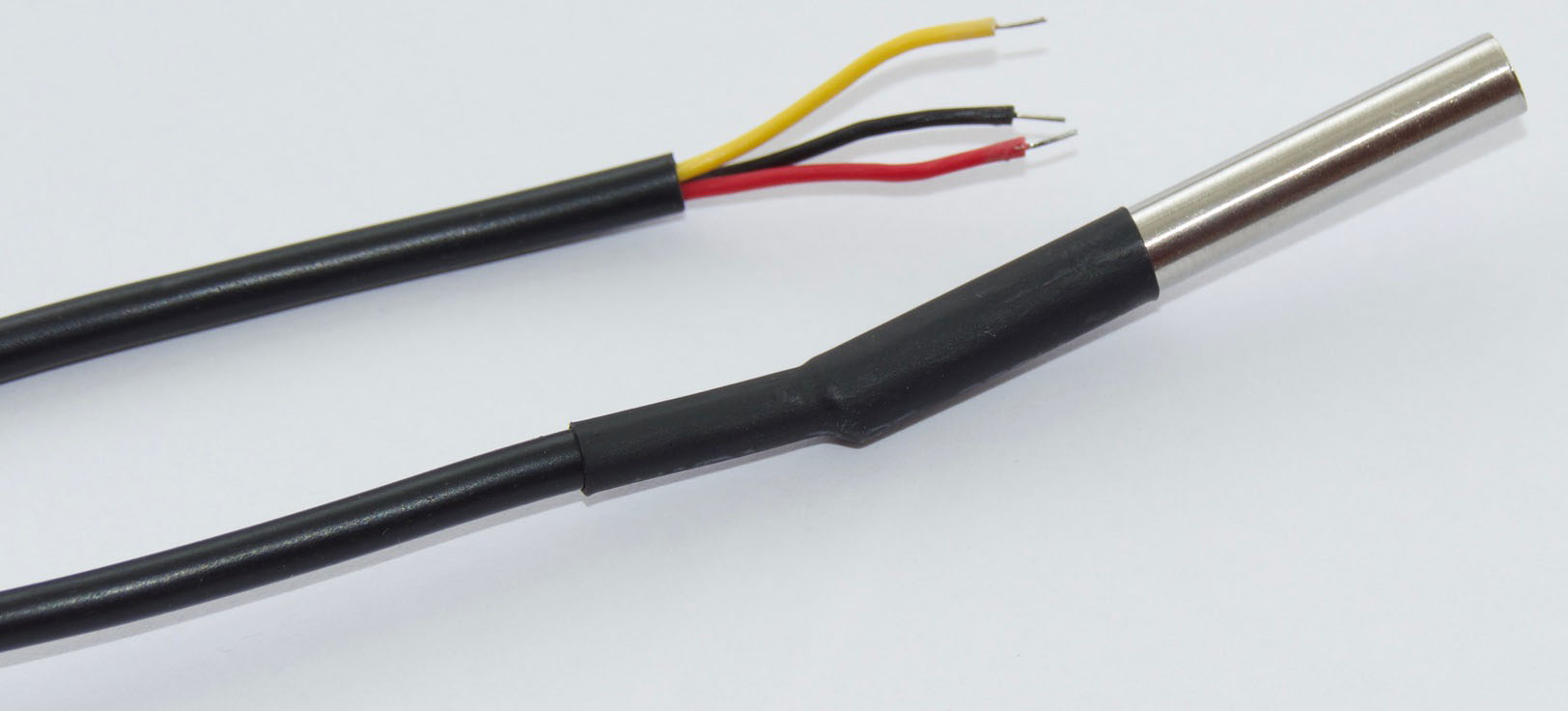

Lesson14 - integrate DS18B20 temperature sensor to home assistant - admin - 04-12-2022
DS18B20 temperature range: -55°C to +125°C and is accurate to ±0.5°C
ESPHome config:
# Example configuration entry
dallas:
  - pin: 4
    update_interval: 5s
# Individual sensors
sensor:
  - platform: dallas
    address: 0x69062162d9ec4328
