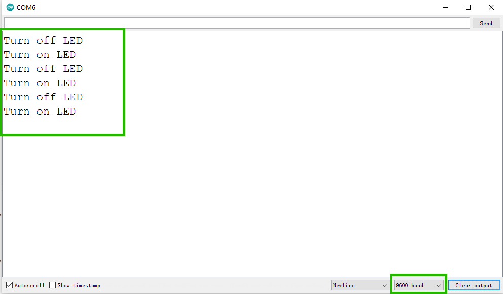

  /*the raw_code of your remote button,you can get it by our
    example [Arduino IDE demo source code for KC868-SERVER]--#02-IR_RECEIVE code*/
        Serial.println("Turn on LED");
        irsend_23.sendNECRaw(0xF807FF00, sRepeats);   //  0xF807FF00  is the raw_code  of led on
        delay(1000);
        Serial.println("Turn off LED");
        irsend_23.sendNECRaw(0xF906FF00, sRepeats);  //   0xF906FF00 is the raw_code  of led Off
        delay(1000);
This code will turn on LED and delay 1s turn off LED
The raw_data of LED on is 0xF807FF00  ,you can decode the data by our example code
"[Arduino IDE demo source code for KC868-SERVER]--#02-IR_RECEIVE code"
