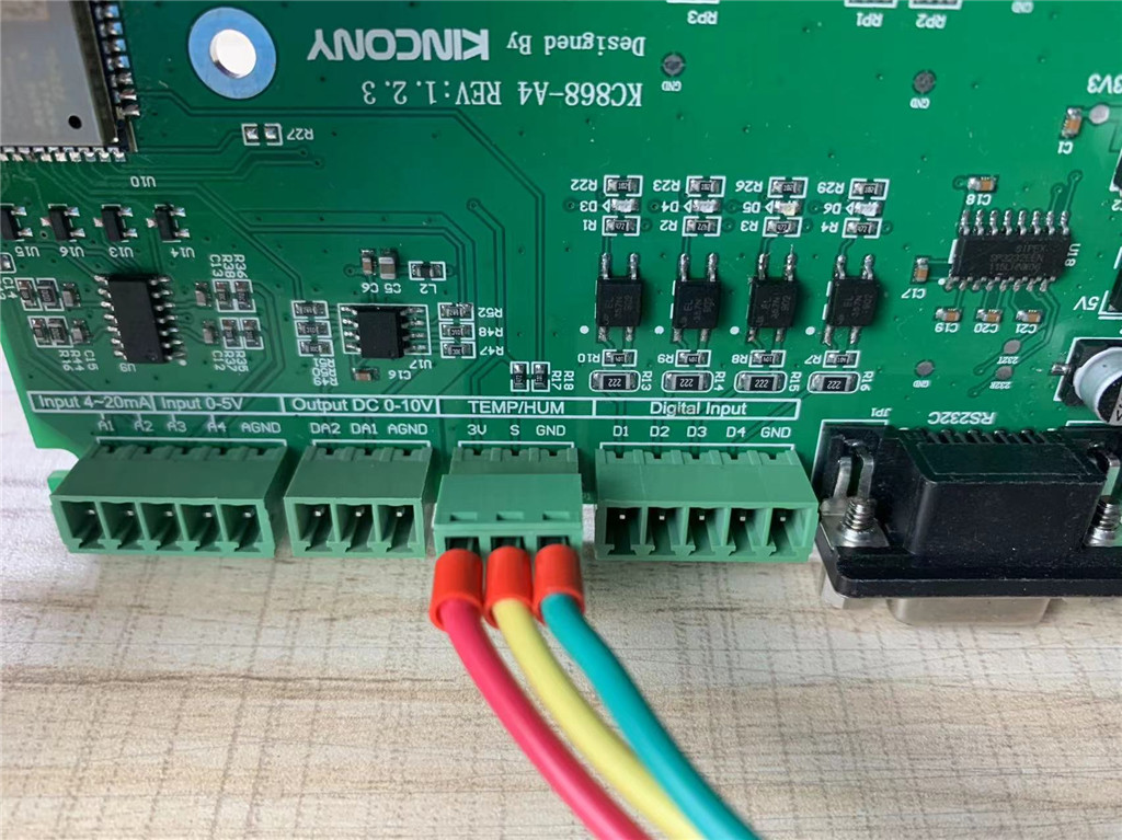

these 10pcs of DS18B20 temperature sensors work with one ESP32 GPIO. program will print 10 sensor's value at the same time.

RE: [Arduino source code for KC868-A4]-18 one GPIO with multiple DS18B20 sensor - flatulentflamingo - 01-06-2023
Is there a builtin 4.7k Ohm resistor already between the data and vcc line on the board?
What a pity this board does not have ethernet...
RE: [Arduino source code for KC868-A4]-18 one GPIO with multiple DS18B20 sensor - admin - 01-07-2023
Yes, the "S" pin printed on PCB have 4.7K Ohm resistor already between the data and vcc line on the board.
developing new "A4S" version now, will add the ethernet.
