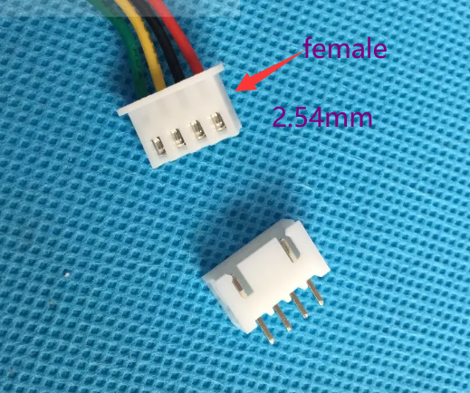

Could you help me identify which model/brand the white IIC extender socket  is on the A32 board? So I can buy the proper female connector to plug into it. Thank you.
RE: Specific libraries to compile the KC868-A32 Demo - admin - 10-20-2022
any 2.54mm plugin can be used, easy to find in market.
