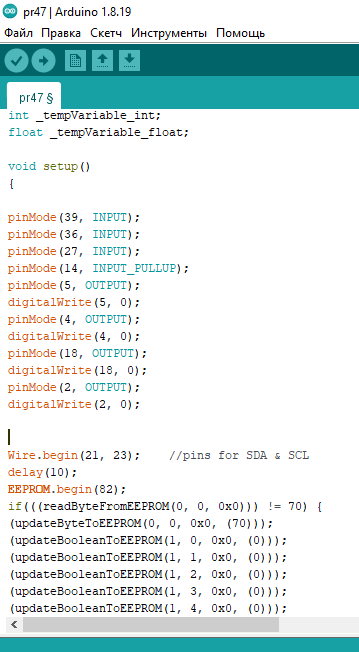

how to change IIC SDA SCL pin in arduino config file - admin - 11-26-2022 find that file, replace SDA and SCL with your board's. RE: how to change IIC SDA SCL pin in arduino config file - GDN20 - 11-28-2022 (11-26-2022, 12:58 AM)admin Wrote: find that file, replace SDA and SCL with your board's. I just have to do this... RE: how to change IIC SDA SCL pin in arduino config file - admin - 11-28-2022 yes, this is another way, not need to change config file, write in code, just need the arduino function supported. |
