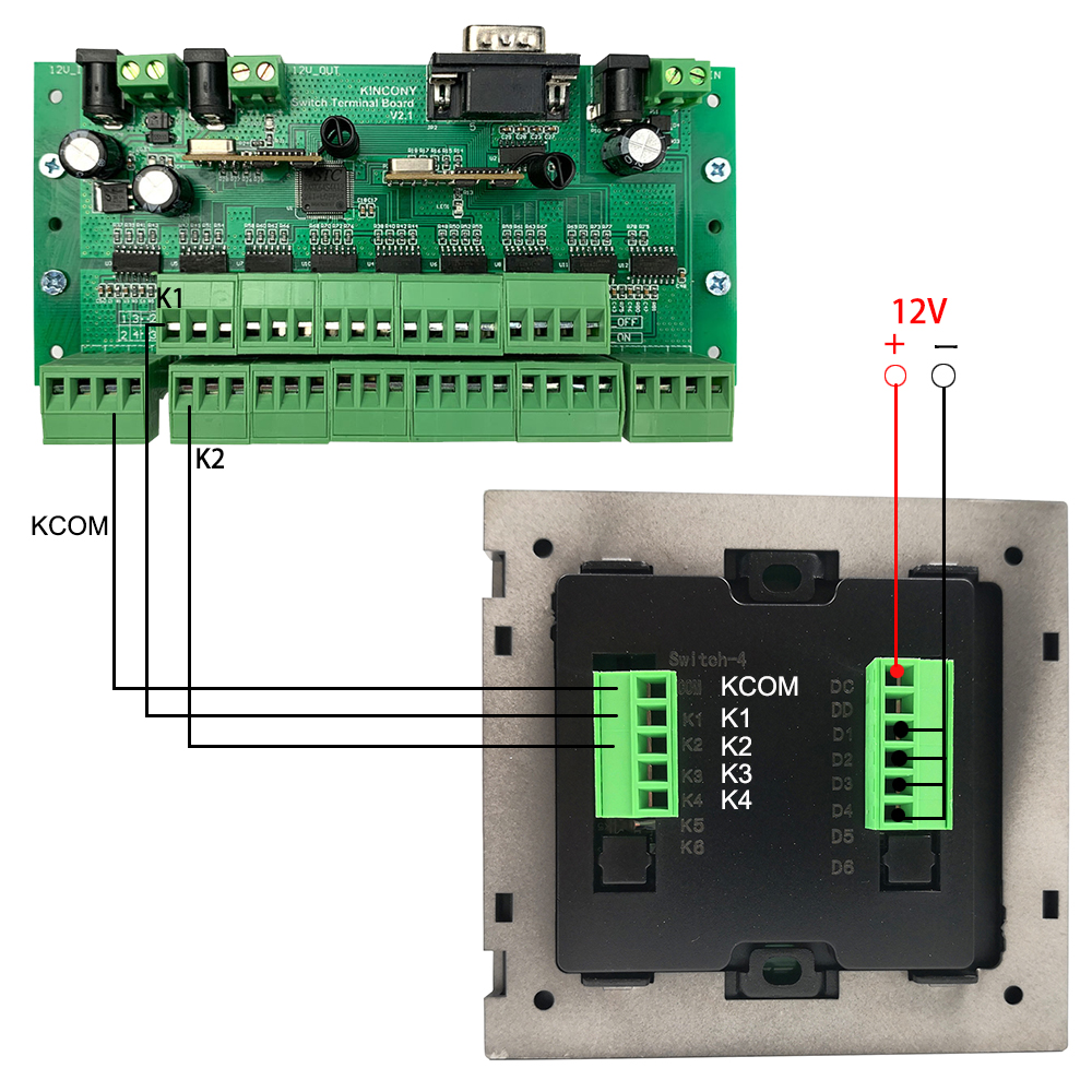

attach pic of  switch module boards and switch
and I use 29 on/off switches and 6 pir sensor  and it needs a 12 volt source as well
