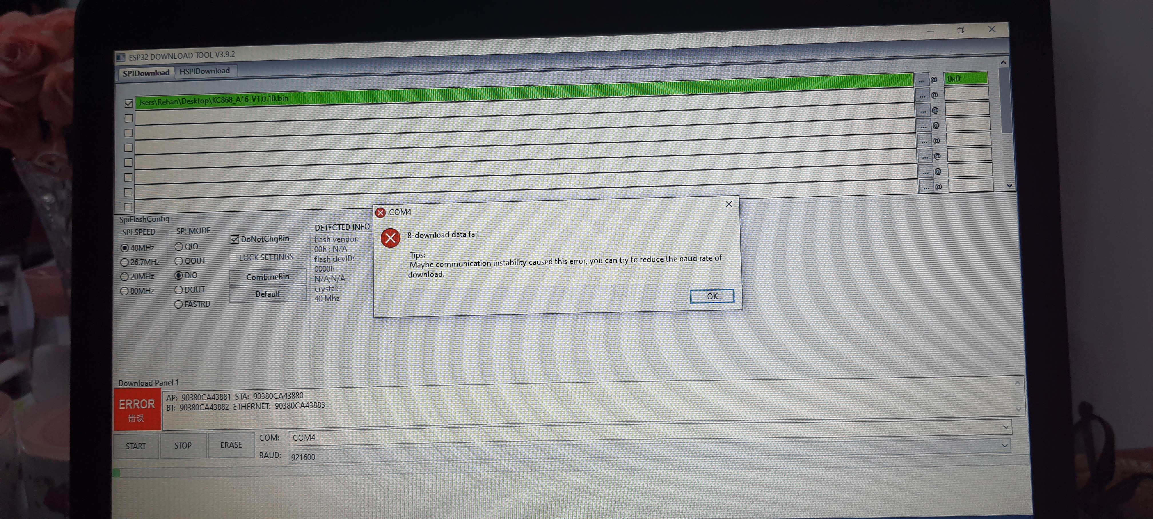

(01-12-2023, 12:26 AM)admin Wrote: not soon, but this year, all KC868-A series board will have new firmware.
Hi sir I try to download new firmware to a16  but always showing   msg reduce baudrate  reduce and try   many time but same massage appears   pls check
RE: For a 16 firmware - admin - 01-28-2023
do you have changed another USB-C cable for a test? some times the cable only use for charge battery.
RE: For a 16 firmware - reehanlambe - 01-28-2023
Resolved issue I removed mh433 sender and reciver and try its work for upload software
