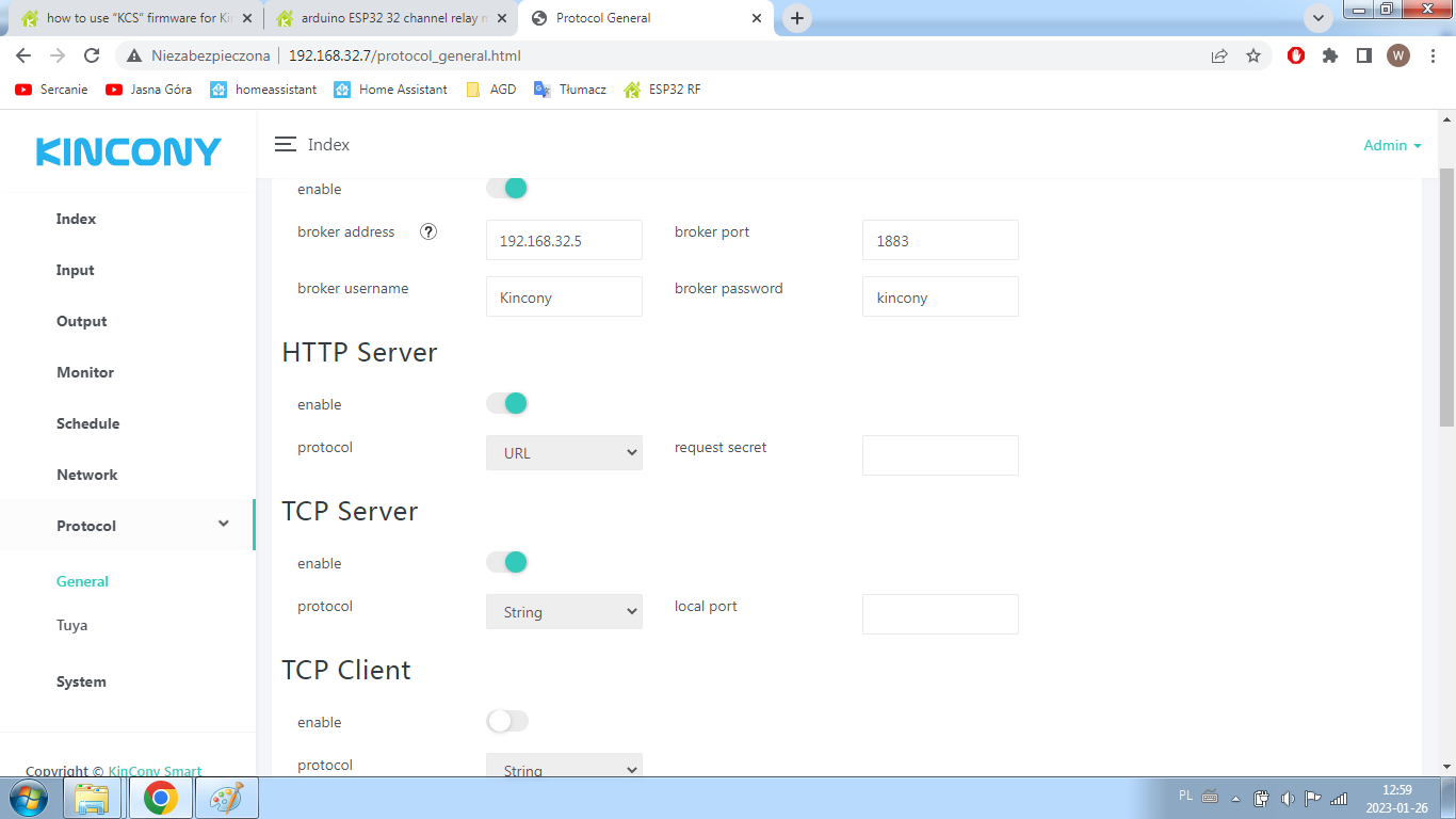

However, I have a question about MQTT setup.
I entered username, password, port 1883, brooker address. This data seems to be correct, but mqtt status in KCS monitor is disconnected.

RE: Connection to the Home Assistant app? - admin - 01-26-2023
"MQTT" broker address: you should use mqtt://192.168.32.5 now you are using 192.168.32.5 need add mqtt://
RE: Connection to the Home Assistant app? - Wojtek - 01-26-2023
Ok, thx, its connected now.

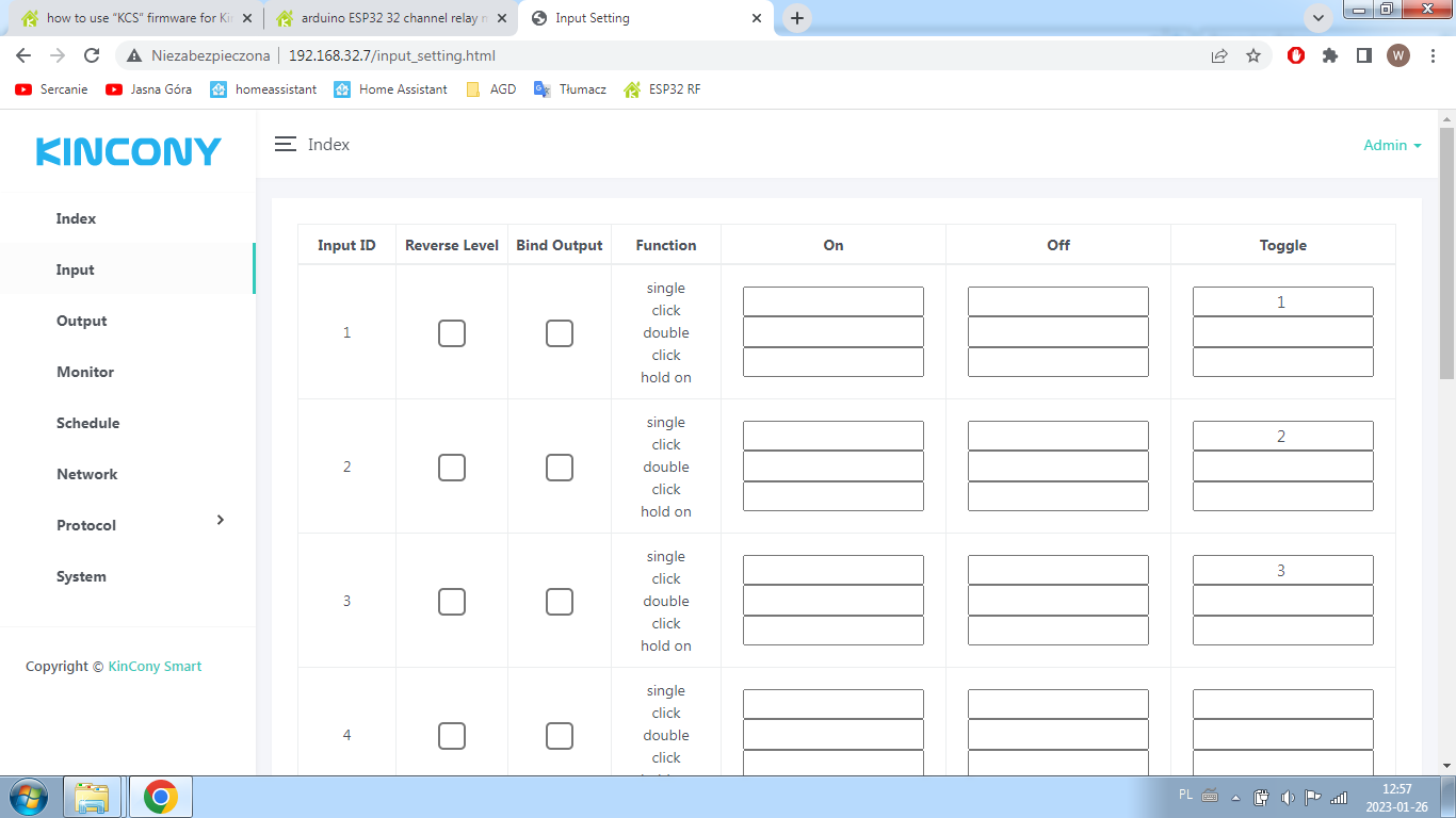

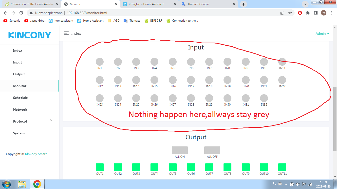

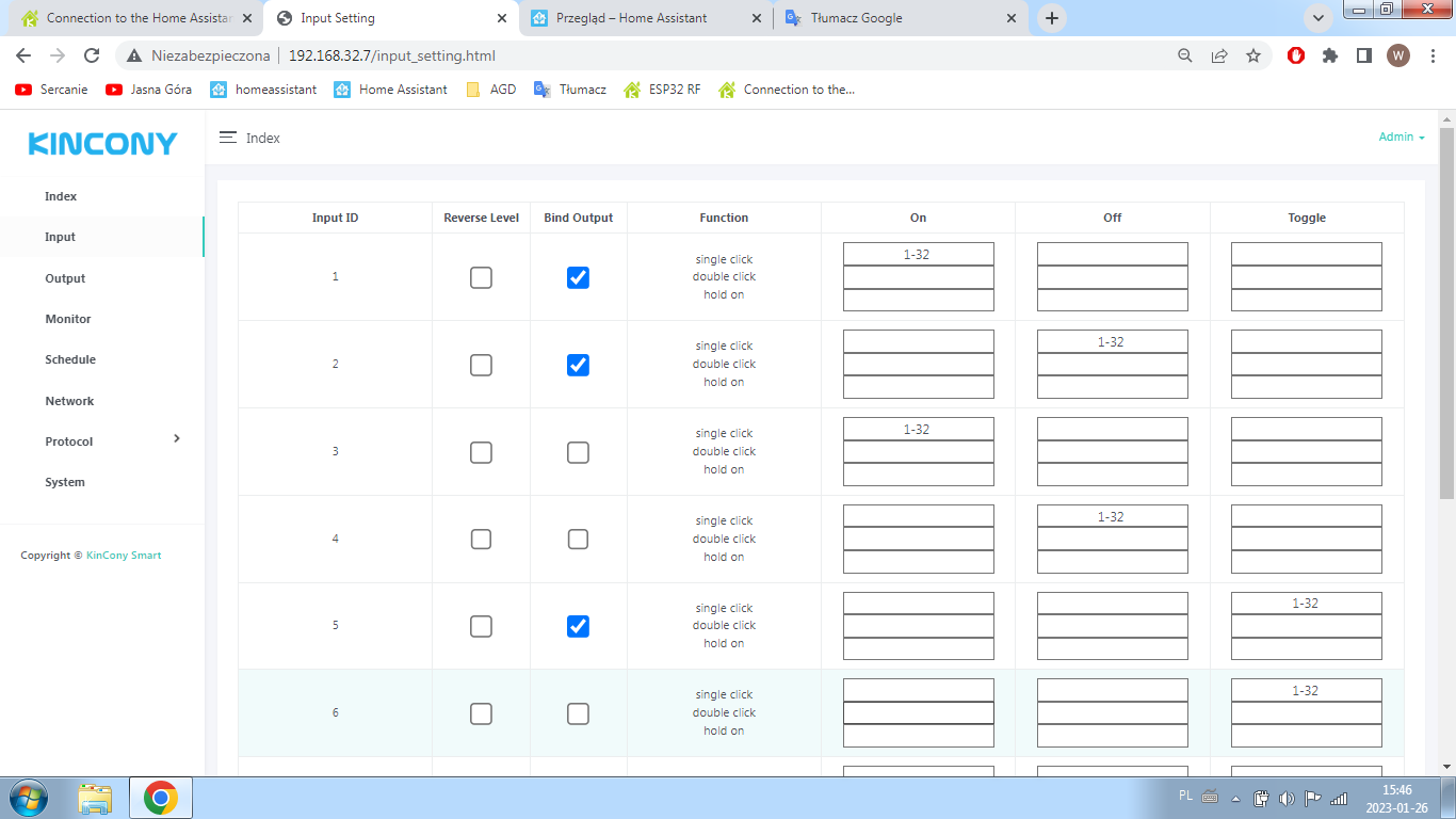

After uploading KCS, I have the impression that it does not detect inputs from switches shorting to GND. Previously, the input shorting to ground gave a temporary activation of the output contactor on the board.
RE: Connection to the Home Assistant app? - admin - 01-27-2023
we will begin work at 1-29-2023, then give you feedback.
RE: Connection to the Home Assistant app? - Wojtek - 01-27-2023
Happy New Year!
RE: Connection to the Home Assistant app? - admin - 01-29-2023
ok, we have tested, after some days later i will send you new firmware.
