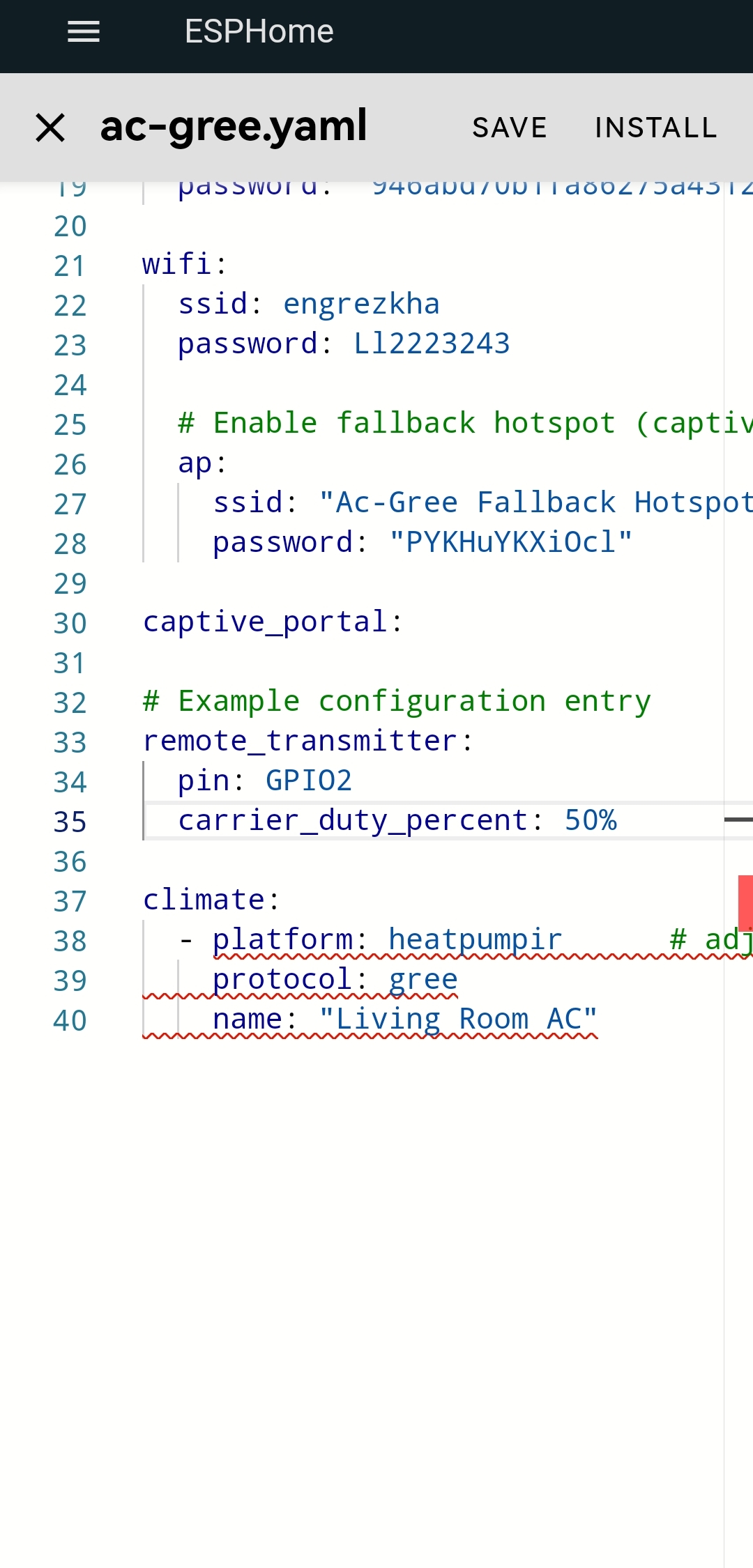

RE: how learn KC868-AG ir remote for air conditioners of an unknown brand - engmohades - 05-04-2023
CAN help me to correct error
RE: how learn KC868-AG ir remote for air conditioners of an unknown brand - admin - 05-04-2023
before your "protocol" should have a "space".
When take space appear red line
RE: how learn KC868-AG ir remote for air conditioners of an unknown brand - admin - 05-05-2023
you have not define IR receiver gpio , how it works?
see detail at here: https://esphome.io/components/climate/climate_ir.html
RE: how learn KC868-AG ir remote for air conditioners of an unknown brand - engmohades - 05-05-2023
Please share configration yaml file for esphome for KC868-AG
I have gree AC
