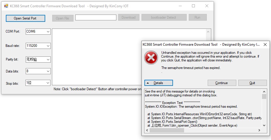

upgrade firmware v1.39 kc868-h32bs - mutaz - 03-01-2023 hi i have kc868-h32bs v1.39 . i'm trying to upgrade the firmware . i downloaded KC868 Controller Bootloader and used serial to usb cable to upgrade but every time i run it i get error is there a way to upgrade using ethernet? if not what's the solution RE: upgrade firmware v1.39 kc868-h32bs - admin - 03-01-2023 1. Connect with USB-RS232 cable. 2. check COM port in your windows OS "Device manager" 3. fill COM port to bootloader tool. RE: upgrade firmware v1.39 kc868-h32bs - mutaz - 03-01-2023 (03-01-2023, 08:05 AM)admin Wrote: 1. Connect with USB-RS232 cable. i checked and updated but still same error. see image RE: upgrade firmware v1.39 kc868-h32bs - admin - 03-01-2023 maybe your port is occupied. you can reboot of your computer for a test. if also have problem, you can try to use another computer. |
