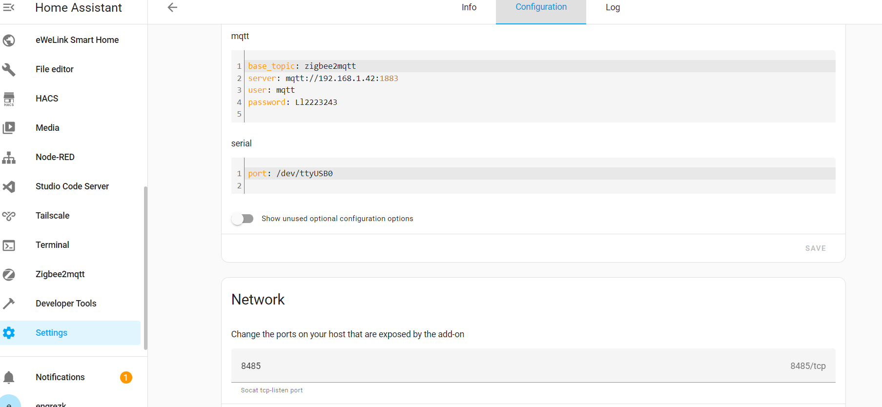

lesson34 - how to install Zigbee 3.0 gateway to home assistant - admin - 03-02-2023 1. install zigbee2mqtt https://github.com/zigbee2mqtt/hassio-zigbee2mqtt 2. add config zigbee2mqtt serial: port: tcp://192.168.1.201:6638 adapter: ezsp 3. config (Zigbee Home Automation) ZHA socket://192.168.1.201:6638 band: 115200 RE: lesson34 - how to install Zigbee 3.0 gateway to home assistant - engmohades - 04-09-2023 Thanks iam using zigbee dongole and want use many gateway also how to config it ? can you send me configration ? RE: lesson34 - how to install Zigbee 3.0 gateway to home assistant - admin - 04-10-2023 you need to check your serial device name in your home assistant. our name not sure as same as your serial device name. RE: lesson34 - how to install Zigbee 3.0 gateway to home assistant - engmohades - 04-10-2023 (04-10-2023, 12:50 AM)admin Wrote: you need to check your serial device name in your home assistant. our name not sure as same as your serial device name. how to check my serial device name in my home assistant ? thank you RE: lesson34 - how to install Zigbee 3.0 gateway to home assistant - admin - 04-10-2023 home assistant -- setting - system - hardware - all hardware RE: lesson34 - how to install Zigbee 3.0 gateway to home assistant - engmohades - 04-11-2023 (04-10-2023, 04:20 AM)admin Wrote: home assistant -- setting - system - hardware - all hardware I was asking about the configran settings, is there anyone who can help me |
