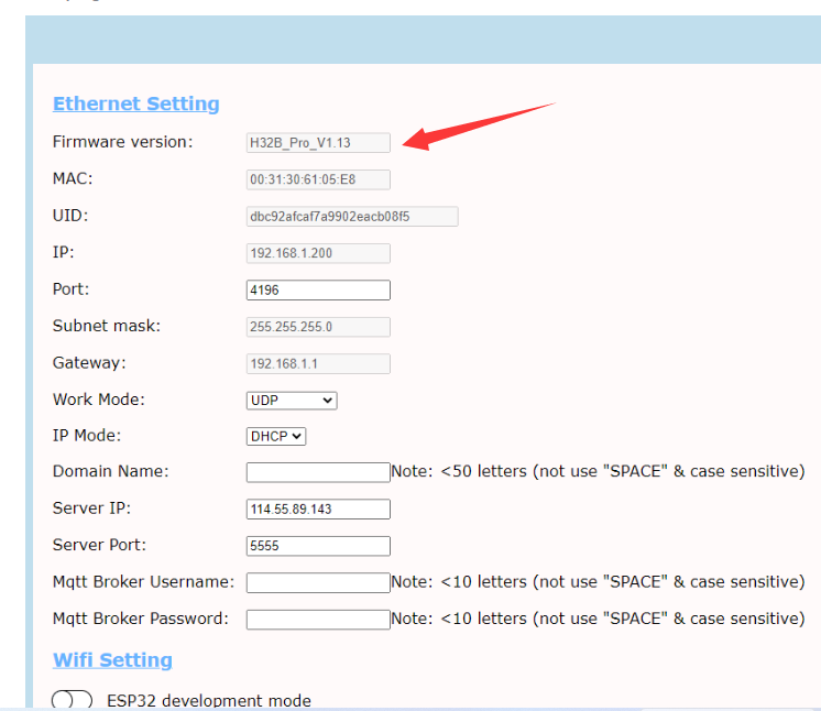

where is say the "firmware version 4.13.34" , take a photo. i think it's your wifi module's firmware version, not controller's firmware.

RE: updating firmware kc868-h32b - admin - 03-07-2023
connect ethernet cable with your controller. open IP address in web browser, then you will see it.

Would’ve helped to know that I needed to hold down the ethernet button until all the lights showed in order to turn it into TCP server static mode.
It shows version H32B_V4.29
Is  Relay32_V437_210907.zip a later version , from the numbering v437 looks later than v429 ?
At least I have access to the config , I assumed wrongly this would have been part of the web page available by Wi-Fi.
https://www.kincony.com/forum/showthread.php?tid=2343 this is the newest version V4.46
yes, large number version is newer.
