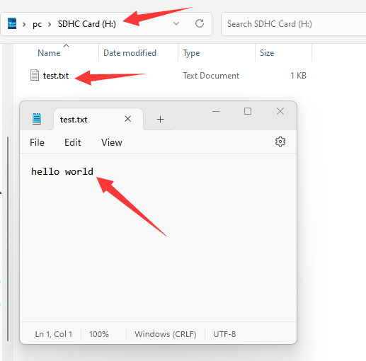

after program running, we will find "hello word" have wrote to txt file and saved SD card.
SD card use by "1BIT_SDMMC" work mode.
