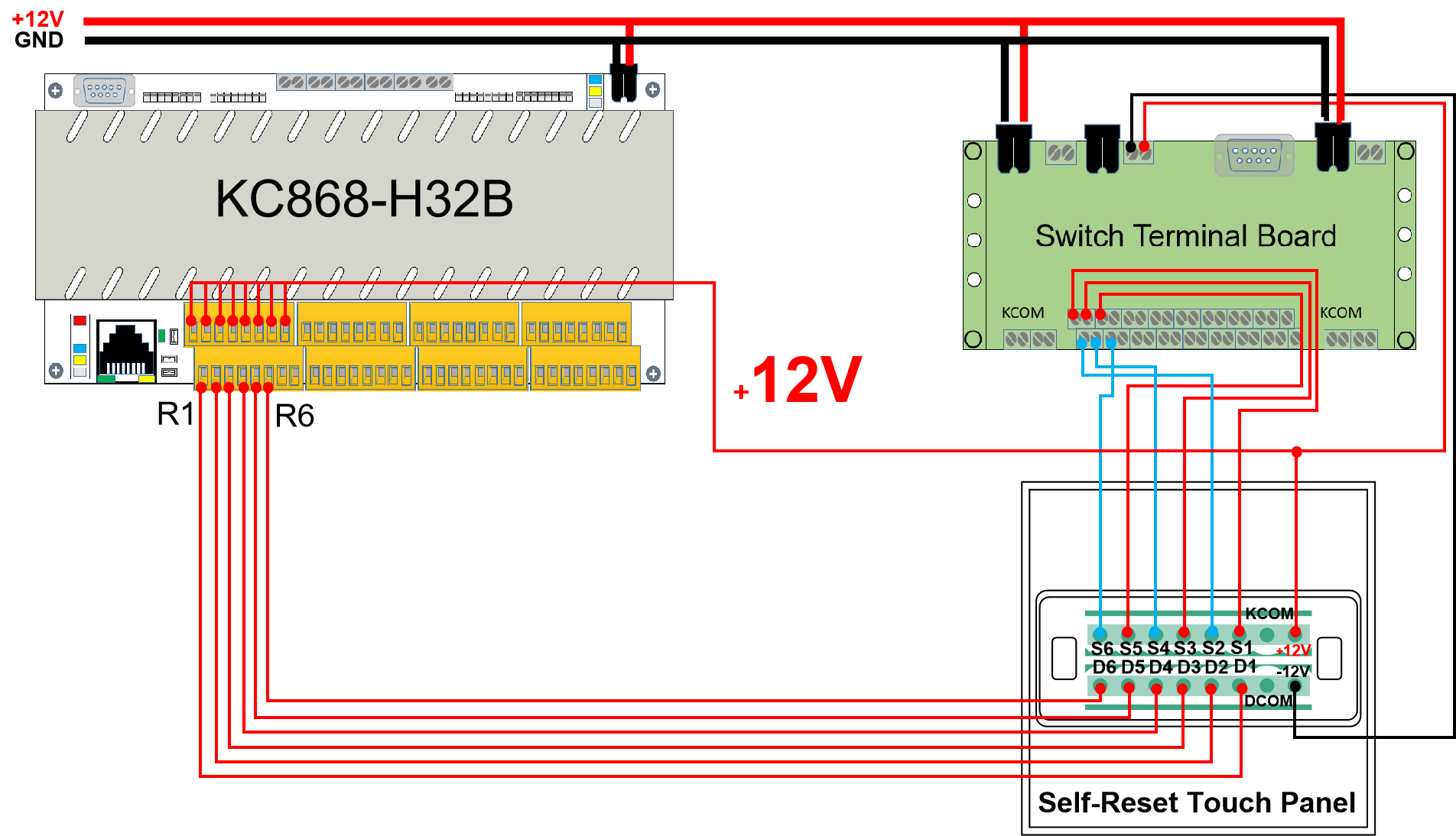

Momentry Switches A4S - mark2023 - 05-07-2023 Hello, I have a A4S Controller and a 2 button glass momentry switch and a 6 button momentry switch. Can someone share a wiring diagram for both these switches onto the A4S. I connected the glass switch but the input was permantly on in HA and pessing the switch made no difference. If i could have a wiring digram for all terminals on the switches as a example that would be great. RE: Momentry Switches A4S - admin - 05-08-2023 can you take a photo how to wire. just let switch's KEY line to A4S' board digital input port. KCOM with GND. here is diagram for KC868-A4, but A4S is similar: https://www.kincony.com/forum/showthread.php?tid=2500 RE: Momentry Switches A4S - mark2023 - 05-08-2023 (05-08-2023, 12:52 AM)admin Wrote: can you take a photo how to wire. just let switch's KEY line to A4S' board digital input port. KCOM with GND. Yes i wire that way amd it works but not using the DCOM, D1,D2 etc. Can you show a diagram how to connect that way so we can use the led state change. RE: Momentry Switches A4S - admin - 05-09-2023 D1,D2... if use for LED state feedback. your A4S output port feedback +12v to D1,D2.... so that LED on switch panel will be ON. if you want to test, you can connect D1,D2 with +12v, so that switch panel's LED will be ON. RE: Momentry Switches A4S - mark2023 - 05-09-2023 Can these be wired in the same terminals as the com and K1? When I wired just dcom to gnd and input 1 the input stayed pemantly active. If you have a drawing of both d1 and k1 connected that will be great RE: Momentry Switches A4S - admin - 05-09-2023 COM and GND is same point. it's connected internel on PCB. this is sample diagram H32B with switch terminal board for wall switch panel: |
