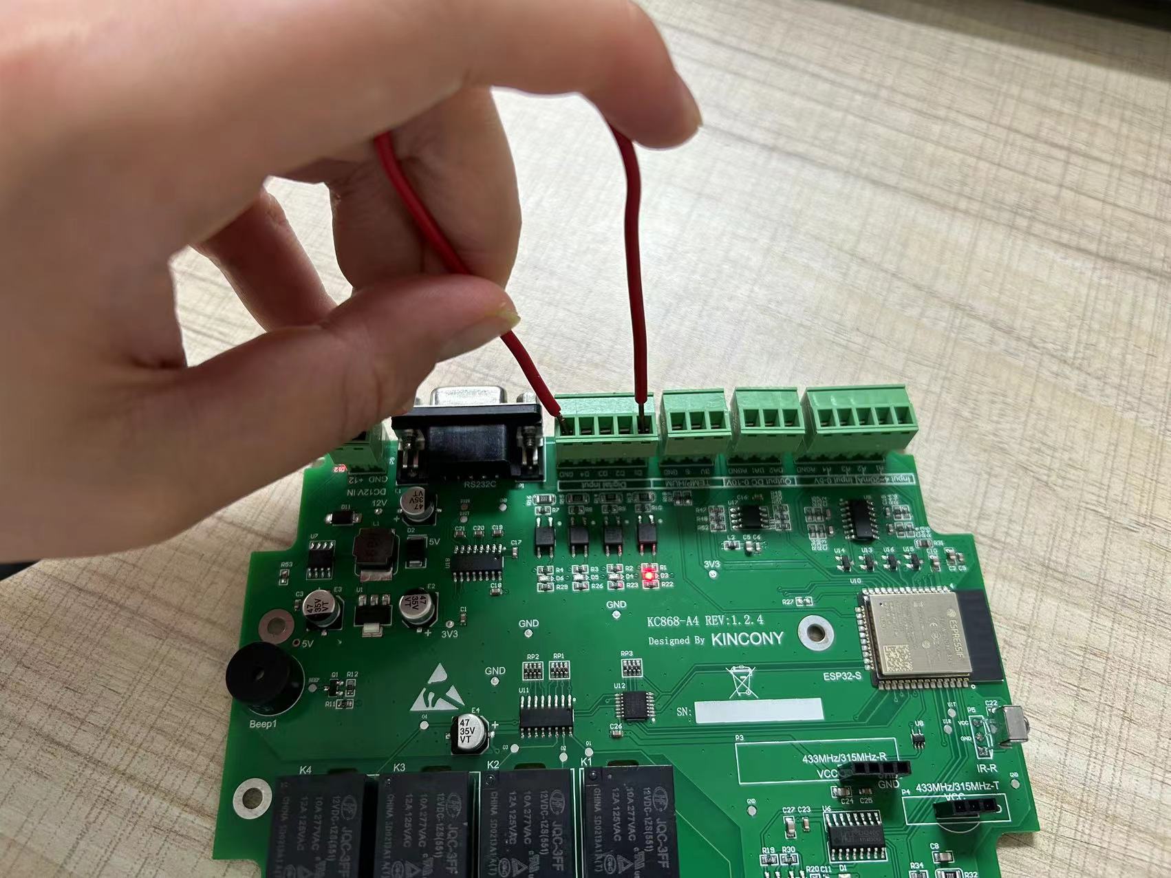

Template for KC868-A4 Tasmota - VascoTeixeira - 05-16-2023 I am using this template {"NAME":"KC868-A4","GPIO":[32,0,227,0,224,225,0,0,0,1312,1,226,0,0,480,1152,0,1120,1056,1088,0,1,1,1,0,0,0,0,4706,4707,4704,4705],"FLAG":0,"BASE":1} ("https://blakadder.com/kincony-KC868-A4/"). I am using everything except the 4 analogs; instead, I would like to use the digital inputs to connect 4 float switches ("https://www.amazon.es/-/pt/dp/B089VTDG7P/ref=asc_df_B089VTDG7P/?tag=ptgogshpadde-21&linkCode=df0&hvadid=634424762838&hvpos=&hvnetw=g&hvrand=12299730209074816985&hvpone=&hvptwo=&hvqmt=&hvdev=c&hvdvcmdl=&hvlocint=&hvlocphy=20876&hvtargid=pla-943952460943&th=1"). Could you please assist me with the template? Thx Vasco Teixeira RE: Template for KC868-A4 Tasmota - admin - 05-17-2023 your float sensor is dry contact signal, so need use by Digital Input port, not use analog input. just set digital input port in your tasmota config webpage is ok. RE: Template for KC868-A4 Tasmota - VascoTeixeira - 05-17-2023 (05-17-2023, 12:40 AM)admin Wrote: your float sensor is dry contact signal, so need use by Digital Input port, not use analog input. ye im trying to conf it , in tasmota parameterts i need to change GPI14/27/39/36 to what ? https://prnt.sc/TaRaW5vqTg7l RE: Template for KC868-A4 Tasmota - admin - 05-17-2023 for INPUT RE: Template for KC868-A4 Tasmota - VascoTeixeira - 05-23-2023 (05-17-2023, 02:09 AM)admin Wrote: for INPUTI'm new to working with Tasmota =( I changed the template parameters from GPI14/27/39/36 to Input 1/2/3/4. However, when I connect a wire in GND (ground) and the other end on D1 , the light on the board turns on, but nothing happens in the Tasmota console. image in tasmota parameters https://prnt.sc/KKrqXuTmJbHX https://prnt.sc/l1gXfQyrq_Y3 RE: Template for KC868-A4 Tasmota - admin - 05-23-2023 you can do step by step as this video tour: https://youtu.be/8NqOW0HJ4EA RE: Template for KC868-A4 Tasmota - VascoTeixeira - 05-24-2023 (05-23-2023, 10:40 PM)admin Wrote: you can do step by step as this video tour: https://youtu.be/8NqOW0HJ4EA that video you are using switch ( I test it and work fine ) but I don't need switch I need something to show me on console so I can get the info on node-red (I need to know if my float sensor dry contact signal change to on ) I already test input and don't work =( RE: Template for KC868-A4 Tasmota - admin - 05-24-2023 for example, i use digital input-1 with a PIR sensor. you can connect with your float sensor. define GPIO36 as Switch1 A configured PIR will not appear in the web UI in any form. To make it report like a sensor we need a rule that will send movement triggers to an MQTT topic. SwitchMode1 1 SwitchTopic 0 Rule1 on Switch1#state=1 do publish stat/%topic%/PIR1 ON endon on Switch1#state=0 do Publish stat/%topic%/PIR1 OFF endon Rule1 1 now when you short digital input-1 to GND or not short it. you will have feedback message, in your Node-Red, you can received MQTT feedback message for INPUT state: RE: Template for KC868-A4 Tasmota - VascoTeixeira - 05-24-2023 (05-24-2023, 01:52 AM)admin Wrote: for example, i use digital input-1 with a PIR sensor. you can connect with your float sensor. Thx aloooot for the help now i can start working on my node-red I'm using your bord to command my pool xD its perfect =) continue with the great work . RE: Template for KC868-A4 Tasmota - admin - 05-24-2023 you are welcome. |
