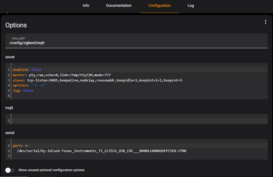

RE: how to config tasmota for AG Pro controller using ZHA in home assistant - homeassistant144 - 12-16-2023
Hello! I tried to look for the steps but couldn't find much helpful. Please guide me to use zigbee2mqtt for your AG pro for configuring zigbee devices with zigbee2mqtt in homeassistant
RE: how to config tasmota for AG Pro controller using ZHA in home assistant - admin - 12-17-2023
if you already can work for "ZHA", ok, not need to download firmware for ESP32 again. just remove "ZHA" from home assistant. then install zigbee2mqtt github Repository is ok.
because they are using same firmware, but "ZHA" and "zigbee2mqtt" can't work at the same time.
here is video tour , how to add zigbee sensor by zigbee2mqtt: https://youtu.be/zBnNGO5HoqY
RE: how to config tasmota for AG Pro controller using ZHA in home assistant - homeassistant144 - 12-17-2023
then how to setup zigbee2mqtt in homeassistant? For the serial part in configuration of zigbee2mqtt in homeassistant, i have to use the ip address of the AG pro?
