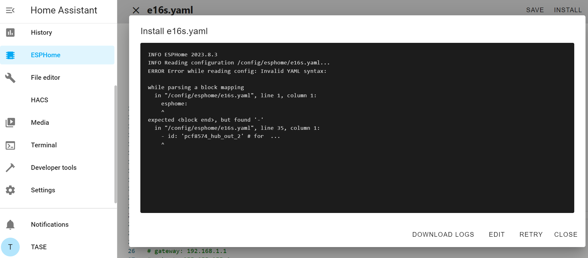

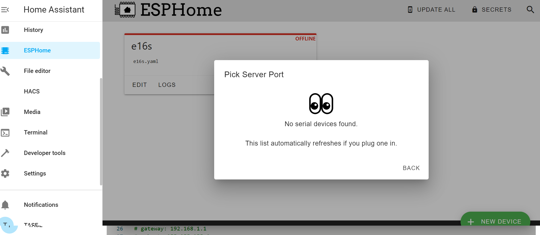

KC868-E16S ESP Home configuration with Home Assistant - Tase - 09-19-2023 Hi, since i am new to this, i need the users with time and patience to help out Have installed ESP Home in Home Assistant, introduced the demo code yaml file (posted here on the frum by other users), but when trying to instal ESP32, by connecting the relay E162 via USB to Server Mini, i do not see the device. Am i missing or doing something wrong? RE: KC868-E16S ESP Home configuration with Home Assistant - admin - 09-19-2023 you should enable CM4 USB port firstly, here is details how to do: https://www.kincony.com/forum/showthread.php?tid=1980 RE: KC868-E16S ESP Home configuration with Home Assistant - Tase - 09-20-2023 Added a new command line in the config file. All ok, although i don't know why do i have error mesage in the E16s boars.yaml file, as i have added the demo code listed on the forum RE: KC868-E16S ESP Home configuration with Home Assistant - Tase - 09-21-2023 Solved it, it was an alignment error in the yaml file. Edited and now it works RE: KC868-E16S ESP Home configuration with Home Assistant - admin - 09-21-2023 ok, good RE: KC868-E16S ESP Home configuration with Home Assistant - Tase - 10-24-2023 Updated the board to v2.1.9 firmware, but somehow i can't make buttons work. Tried via IFTTT to define link between input and output, but it is still unresponsive. Outputs work if selected separately via RUn command or via the monitor menu Any thoughts? Thanks RE: KC868-E16S ESP Home configuration with Home Assistant - admin - 10-24-2023 after you config it, need re power on of your board. RE: KC868-E16S ESP Home configuration with Home Assistant - Tase - 10-24-2023 Solved it today. I unchecked the logical "AND" field. Now it works Thanks RE: KC868-E16S ESP Home configuration with Home Assistant - admin - 10-24-2023 ok, good. |
