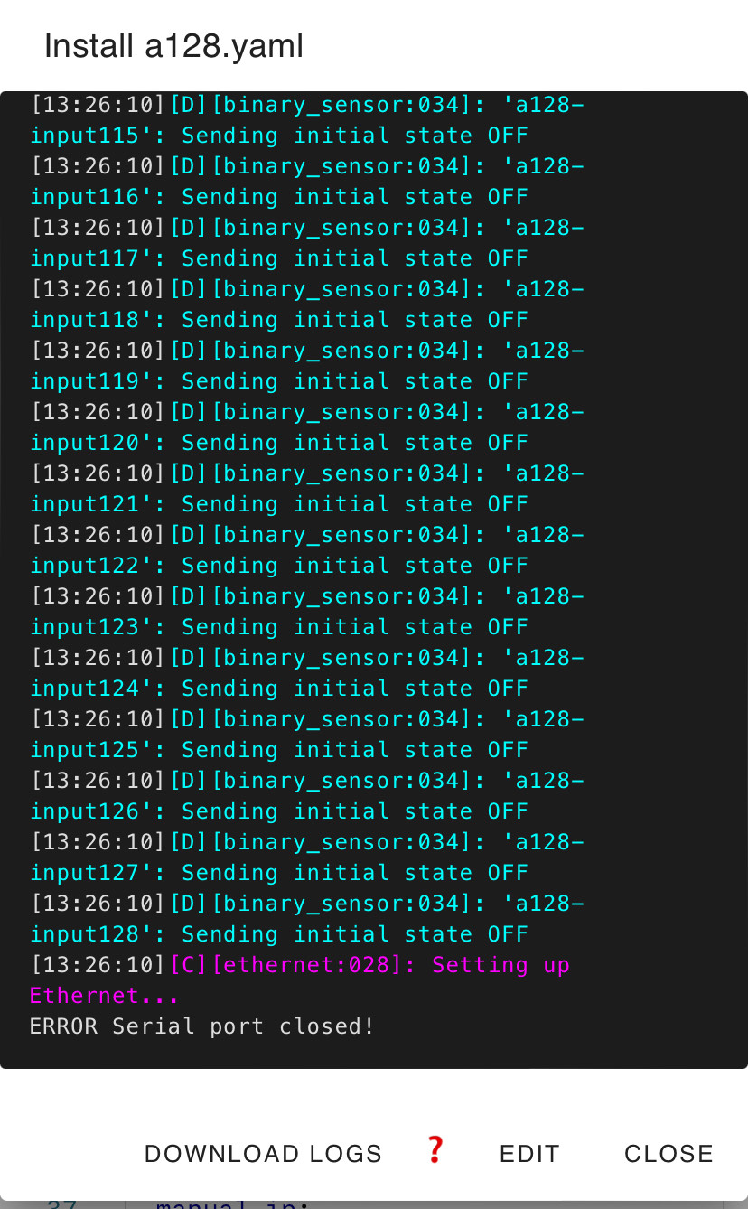

Hi every one
when i try to instal A123, i get error
ERROR Serial port closed!
see attach

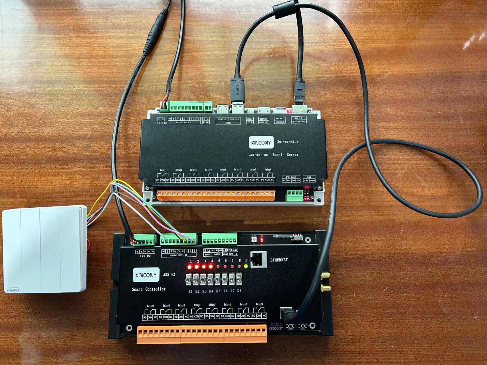

when you connect USB cable to esp32 board, there should be one usb-serial device.
make sure your usb cable have connect to home assistant server's USB port.
RE: error instal A128 - Almhlws - 09-23-2023
i used mini pc as Generic x86-64
RE: error instal A128 - admin - 09-23-2023
A128 usb cable connect to your miniPC's USB port. then check in your home assistant hardware resource.
