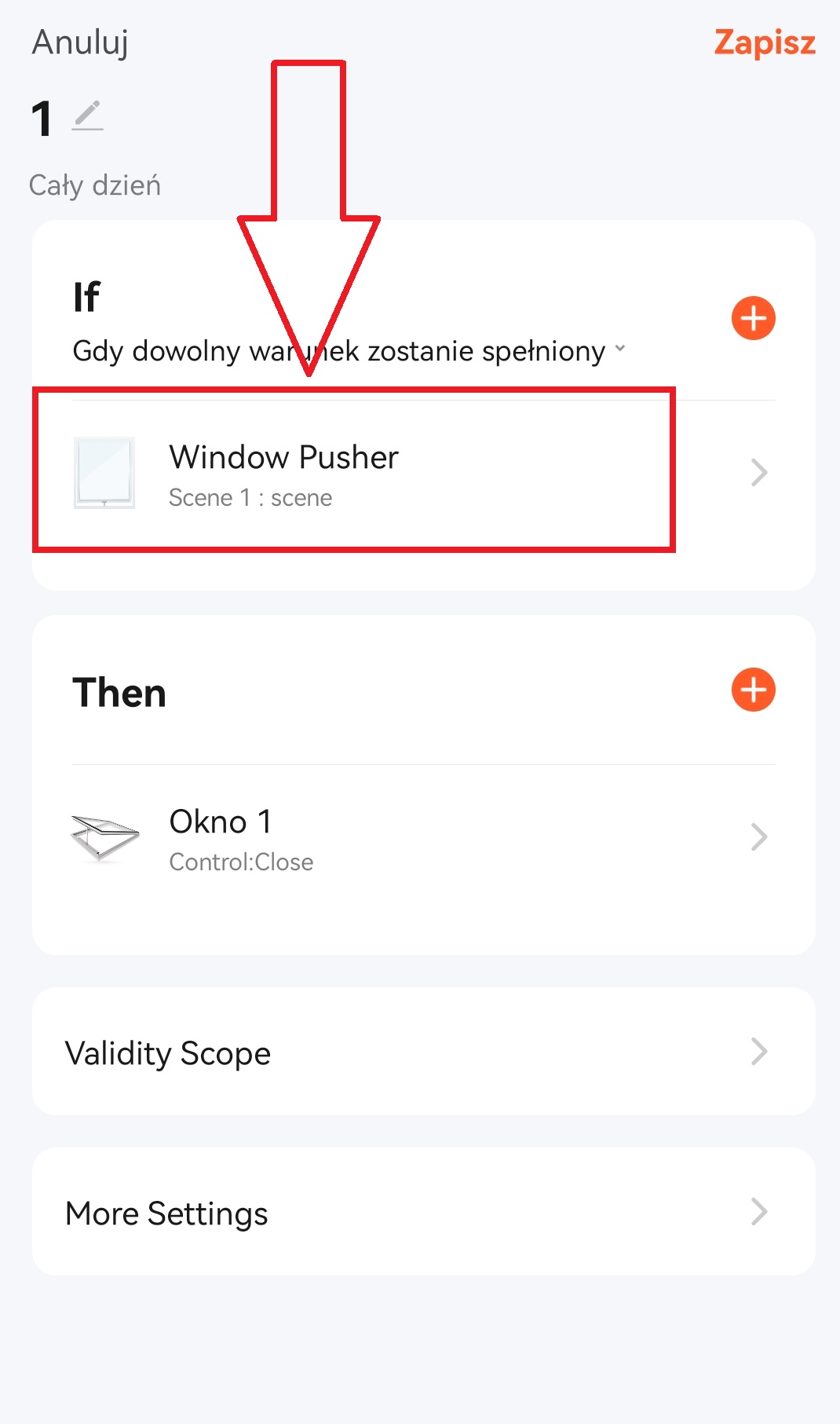

I bought KC868-AG PRO and the problem is that:
- in KC868-A4 PRO for e.g. output 1 there was a signal: output1:off, output 1:on and it worked very well
- in KC868-AG PRO I create e.g. Window Pusher, configured the RF signal but I have no on/off condition, only e.g. Scene1: scene and it doesn't work

Yes and this function works but after learned I can not use this signal in scene. There is no on/off signal, just "Scene 1: scene" not output1:off /on.
about this question, can you take a phone screen photo, where can't see what?
RE: [KC868-AG PRO] Tuya and scenes - zolax - 10-17-2023
(10-16-2023, 11:12 PM)admin Wrote: - in KC868-AG PRO I create e.g. Window Pusher, configured the RF signal but I have no on/off condition, only e.g. Scene1: scene and it doesn't work
I attached screen from A4 and AG.
RE: [KC868-AG PRO] Tuya and scenes - admin - 10-17-2023
if you want received 433M signal THEN turn ON relay. IF "condition" chose KC868-AG Pro --> 433M learned signal.
(10-17-2023, 10:23 AM)admin Wrote: if you want received 433M signal THEN turn ON relay. IF "condition" chose KC868-AG Pro --> 433M learned signal.
There is no possible to choose KC868-AG-Pro condition. There is only stuff "generated" by it like Window Pusher etc.
Maybe you could make a screen with KC868-AG-Pro selected as a condition. I have newest Tuya version on the phone.
This was possible with A4 but not with AG.
RE: [KC868-AG PRO] Tuya and scenes - KinCony Support - 10-18-2023

According to your question, I think you can use 3 pieces of KC868-A4, then the wireless signal will be programmed 32*3=96, we ask the tuya support ,it is not support  received RF signal to be an if command, tuya app cannot implement the IF command like KC868-A4.
