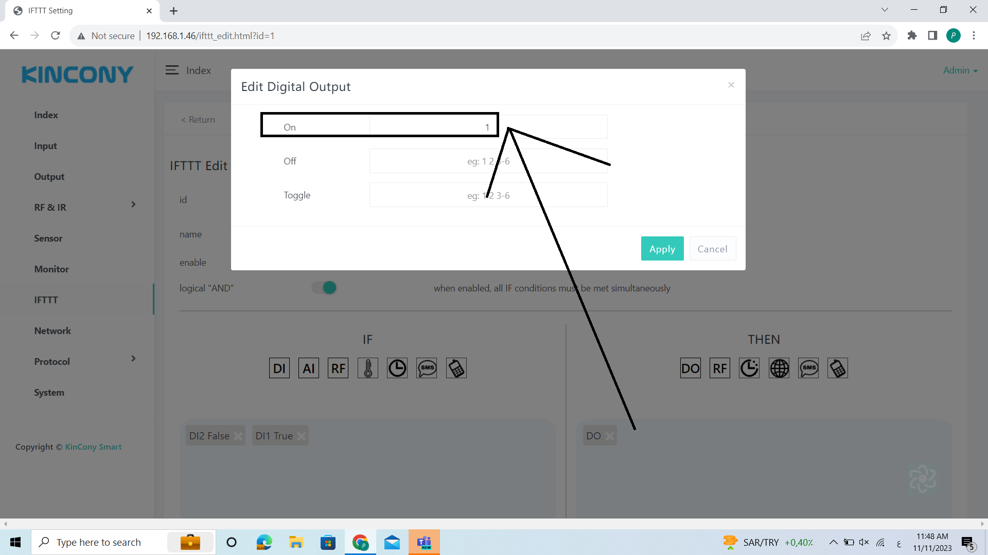

RE: Failed Automation and Conditional Control of Output 1 - admin - 11-11-2023
can you take a photo of your IFTTT setting screen.

RE: Failed Automation and Conditional Control of Output 1 - engmohades - 11-12-2023
(11-11-2023, 12:37 PM)admin Wrote: not use 1 IFTTT command. create 2 IFTTT command, one is for ON, another is for OFF.
I used 2 of the IFTTT  as shown in the previous attachment.
1- IF INPUT1 True and INPUT2 false THEN TUREN ON OUPUT1. ( using and condition )
2- IF INPUT1 True and INPUT2 True THEN TUREN OFF OUPUT1. ( using and condition )
3-  IF INPUT1 false OR INPUT2 True THEN TUREN OFF OUPUT1. ( using or condition )
RE: Failed Automation and Conditional Control of Output 1 - admin - 11-12-2023
IFTTT-1: IF INPUT1 Ture THEN TOGGLE OUTPUT1
IFTTT-2: IF INPUT2 Ture THEN TOGGLE OUTPUT1

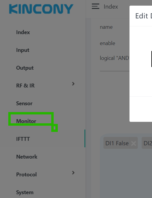

RE: Failed Automation and Conditional Control of Output 1 - KinCony Support - 11-13-2023
In the monitor screen, first check to see if the input 1 and input 2 are really triggered
