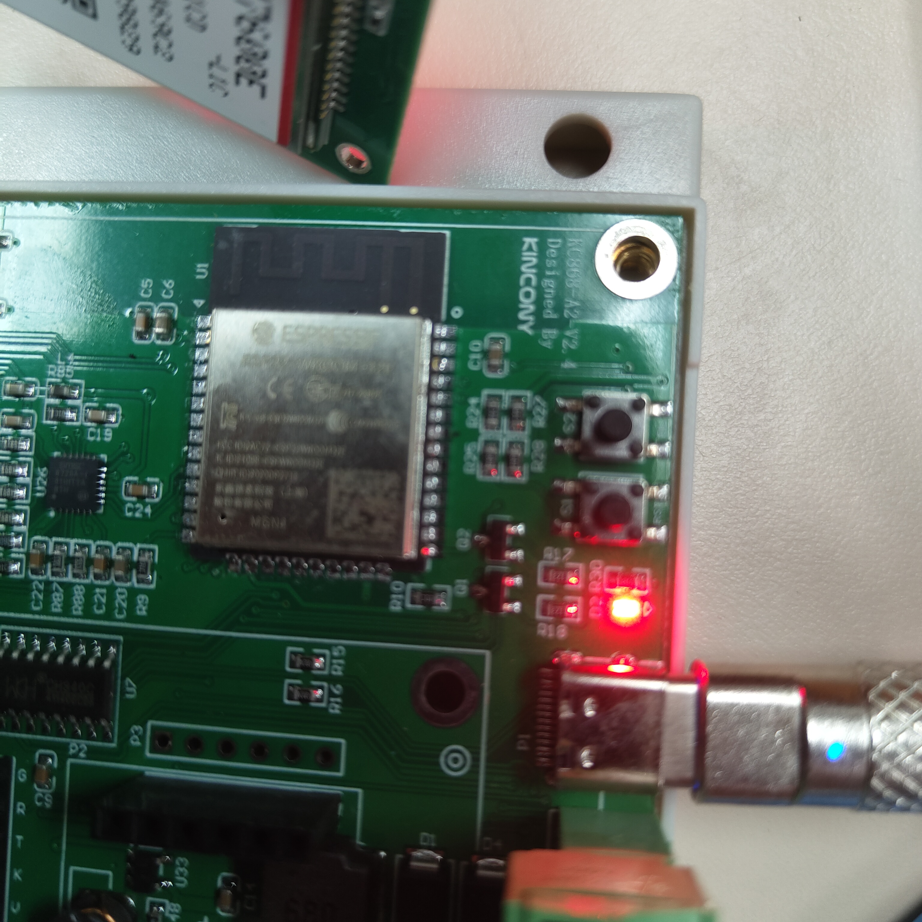

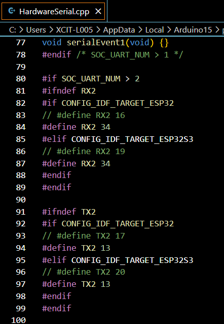

Issue with GSM Pin Connect - airantoujc - 11-15-2023 Board is powered. SIM7600E-L1C breakout is powered. Link to board image: https://imgur.com/a/sKNGmZm Issue: PIN TX RX definition cannot be swapped. Situation 1: TX is 13, RX is 34 = Programs but no GSM connection can be made, no data can be requested from the SIM7600E-L1C. Situation 2: TX is 34, RX is 13 = Backtrace Error logs. Link to errors: https://imgur.com/a/D2MaYXh RE: Issue with GSM Pin Connect - admin - 11-15-2023 whether your A2 PCB is v1.4? photo not clearly. RE: Issue with GSM Pin Connect - airantoujc - 11-15-2023 (11-15-2023, 02:04 AM)admin Wrote: whether your A2 PCB is v1.4? photo not clearly. A2 PCB is V2 (11-15-2023, 02:06 AM)airantoujc Wrote:(11-15-2023, 02:04 AM)admin Wrote: whether your A2 PCB is v1.4? photo not clearly. See this img instead, thank you RE: Issue with GSM Pin Connect - admin - 11-15-2023 ardunio board chose "NodeMcu-32S". RE: Issue with GSM Pin Connect - airantoujc - 11-15-2023 (11-15-2023, 02:23 AM)admin Wrote: ardunio board chose "NodeMcu-32S". still same issue with node32s board pick still cannot switch pin define without backtrace error, changed hardware cpp pin define also doesn't work. can i also check what is the power pin for the GSM ? RE: Issue with GSM Pin Connect - airantoujc - 11-16-2023 Arduino settings below and hardware serial cpp changes attached #define TX2 13 #define RX2 34 void modemHandler() { String res; SerialMon.println("========INIT========"); modem.init(); SerialMon.println("========SIMCOMATI======"); modem.sendAT("+SIMCOMATI"); modem.waitResponse(1000L, res); res.replace(GSM_NL "OK" GSM_NL, ""); SerialMon.println(res); res = ""; SerialMon.println("======================="); SerialMon.println("=====Preferred mode selection====="); modem.sendAT("+CNMP?"); if (modem.waitResponse(1000L, res) == 1) { res.replace(GSM_NL "OK" GSM_NL, ""); SerialMon.println(res); } res = ""; SerialMon.println("======================="); SerialMon.println("=====Preferred selection between CAT-M and NB-IoT====="); modem.sendAT("+CMNB?"); if (modem.waitResponse(1000L, res) == 1) { res.replace(GSM_NL "OK" GSM_NL, ""); SerialMon.println(res); } res = ""; SerialMon.println("======================="); String name = modem.getModemName(); SerialMon.println("Modem Name: " + name); String modemInfo = modem.getModemInfo(); SerialMon.println("Modem Info: " + modemInfo); for (int i = 0; i <= 4; i++) { uint8_t network[] = { 2, /*Automatic*/ 13, /*GSM only*/ 38, /*LTE only*/ 51 /*GSM and LTE only*/ }; SerialMon.printf("Try %d method\n", network[i]); modem.setNetworkMode(network[i]); delay(1000); bool isConnected = false; int tryCount = 60; while (tryCount--) { int16_t signal = modem.getSignalQuality(); SerialMon.print("Signal: "); SerialMon.print(signal); SerialMon.print(" "); SerialMon.print("isNetworkConnected: "); isConnected = modem.isNetworkConnected(); SerialMon.println(isConnected ? "CONNECT" : "NO CONNECT"); if (isConnected) { break; } delay(500); digitalWrite(LED_PIN, !digitalRead(LED_PIN)); } } } void setup() { // Set console baud rate SerialMon.begin(38400); delay(1000); pinMode(LED_PIN, OUTPUT); //modemPowerOn(); SerialMon.println("Wait..."); // Set GSM module baud rate SerialAT.begin(UART_BAUD, SERIAL_8N1, RX2, TX2); delay(3000); SerialMon.println("Initializing modem..."); modemHandler(); digitalWrite(LED_PIN, LOW); String modemInfo = modem.getModemInfo(); SerialMon.print("Modem Info: "); SerialMon.println(modemInfo); #if TINY_GSM_USE_GPRS // Unlock your SIM card with a PIN if needed if (GSM_PIN && modem.getSimStatus() != 3) { modem.simUnlock(GSM_PIN); } #endif #if TINY_GSM_USE_WIFI // Wifi connection parameters must be set before waiting for the network SerialMon.print(F("Setting SSID/password...")); if (!modem.networkConnect(wifiSSID, wifiPass)) { SerialMon.println(" fail"); delay(10000); return; } SerialMon.println(" success"); #endif #if TINY_GSM_USE_GPRS && defined TINY_GSM_MODEM_XBEE // The XBee must run the gprsConnect function BEFORE waiting for network! modem.gprsConnect(apn, gprsUser, gprsPass); #endif SerialMon.print("Waiting for network..."); if (!modem.waitForNetwork()) { SerialMon.println(" fail"); delay(10000); return; } SerialMon.println(" success"); if (modem.isNetworkConnected()) { SerialMon.println("Network connected"); } #if TINY_GSM_USE_GPRS // GPRS connection parameters are usually set after network registration SerialMon.print(F("Connecting to ")); SerialMon.print(apn); if (!modem.gprsConnect(apn, gprsUser, gprsPass)) { SerialMon.println(" fail"); delay(10000); return; } SerialMon.println(" success"); if (modem.isGprsConnected()) { SerialMon.println("GPRS connected"); } #endif } void loop() { // Make sure we're still registered on the network if (!modem.isNetworkConnected()) { SerialMon.println("Network disconnected"); if (!modem.waitForNetwork(180000L, true)) { SerialMon.println(" fail"); delay(10000); return; } if (modem.isNetworkConnected()) { SerialMon.println("Network re-connected"); } #if TINY_GSM_USE_GPRS // and make sure GPRS/EPS is still connected if (!modem.isGprsConnected()) { SerialMon.println("GPRS disconnected!"); SerialMon.print(F("Connecting to ")); SerialMon.print(apn); if (!modem.gprsConnect(apn, gprsUser, gprsPass)) { SerialMon.println(" fail"); delay(10000); return; } if (modem.isGprsConnected()) { SerialMon.println("GPRS reconnected"); } } #endif } } #if TINY_GSM_USE_GPRS && not defined TINY_GSM_MODEM_HAS_GPRS #undef TINY_GSM_USE_GPRS #undef TINY_GSM_USE_WIFI #define TINY_GSM_USE_GPRS false #define TINY_GSM_USE_WIFI true #endif #if TINY_GSM_USE_WIFI && not defined TINY_GSM_MODEM_HAS_WIFI #undef TINY_GSM_USE_GPRS #undef TINY_GSM_USE_WIFI #define TINY_GSM_USE_GPRS true #define TINY_GSM_USE_WIFI false #endif my ifdef is using GSM GPRS RE: Issue with GSM Pin Connect - KinCony Support - 11-16-2023 (11-16-2023, 02:01 AM)airantoujc Wrote: Arduino settings below and hardware serial cpp changes attachedhttps://www.kincony.com/forum/showthread.php?tid=3330 download KCS firmware and test the 4G module. |
