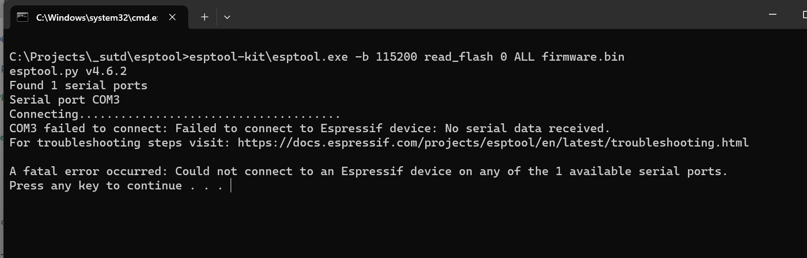

I try using esptool to dump/flash but will not be able to communicate with it

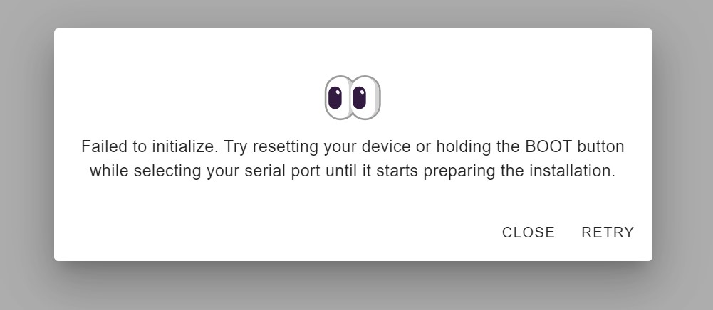

Also try using esphome also same.

RE: KC868-A16 dead? - admin - 12-21-2023
if can't work, need replace the esp32 module. can you replace it?
RE: KC868-A16 dead? - stanchiam - 12-21-2023
(12-21-2023, 02:20 AM)admin Wrote: if can't work, need replace the esp32 module. can you replace it?
i see, now we don't have the tools to do that.
