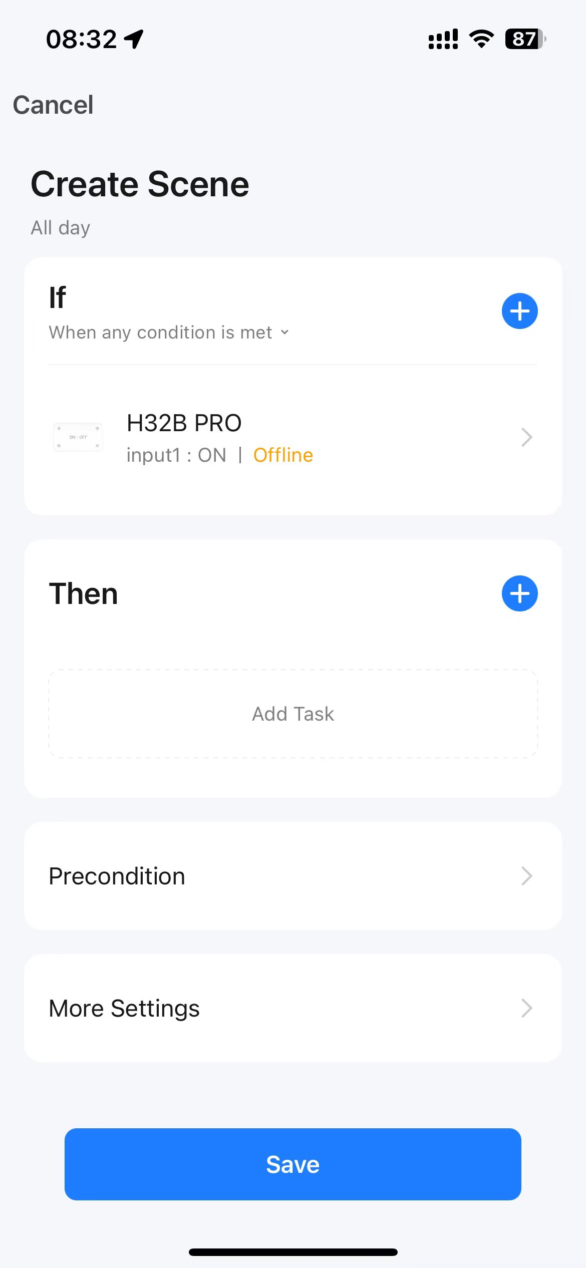

KC868-Ax - Attivazione NOTIFICHE su TUYA SMART LIFE - Pask media_king - 01-02-2024 Saluti a tutti e auguri. Sono nuovo del forum e chiedo aiuto per attivare le notifiche della variazione degli ingressi su una KC868-A4 con licenza TUYA. Puoi aiutarmi gentilmente? Grazie in anticipo a tutti coloro che risponderanno. RE: KC868-Ax - Attivazione NOTIFICHE su TUYA SMART LIFE - admin - 01-02-2024 please write your question in English, now i don't know what's your problem? RE: KC868-Ax - Attivazione NOTIFICHE su TUYA SMART LIFE - Pask media_king - 01-02-2024 Greetings to everyone and best wishes for a happy 2024. I'm new to the forum and I ask for help to activate the notifications of the INPUT change on the card a KC868-A4 with TUYA license and SMART LIFE APP. Can you kindly help me? Thanks in advance to everyone who will respond. RE: KC868-Ax - Attivazione NOTIFICHE su TUYA SMART LIFE - admin - 01-03-2024 1. download KCS firmware to ENABLE tuya prtocol by tuya license, here is online guide: https://www.kincony.com/esp32-kcsv2-firmware.html 2. create SCENE mode in smart-life APP, "When device status changes", Add task by "Send notification" --"Message Notification" . RE: KC868-Ax - Attivazione NOTIFICHE su TUYA SMART LIFE - Lucas35 - 02-22-2024 (01-03-2024, 12:37 AM)admin Wrote: 1. download KCS firmware to ENABLE tuya prtocol by tuya license, here is online guide: https://www.kincony.com/esp32-kcsv2-firmware.html The link doesn't work for me it says it's not available in my region can you fix that? RE: KC868-Ax - Attivazione NOTIFICHE su TUYA SMART LIFE - admin - 02-23-2024 which link can't use? |
