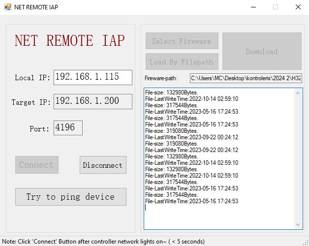

I have H32B which I bought few years ago. I was using it only by "shorting" contacts and everything works, but now I need to add it to HA. I that case I need to update firmware to enable MQTT (I am thinking so). Connecting directly by IP does not work, I hope it will work after update.
Connecting via NET REMOTE IAP works, I connect in 5 seconds after rebooting, ping is successfully returned, but when I choose firmware nothing happens. I have tried different versions of firmware but I am stuck on same result. As I do not know what processor I have, I have tried versions <5.x and >4.4
RE: H32B can not update - admin - 01-21-2024
take a photo of your H32B PCB's CPU chip photo.
on the bottom side of PCB,there is a black big chip, take a photo, we want to see model.
