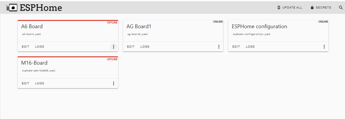

I have a second device that is working fine in Home Assistant. I'm flashing it with the new firmware will share the results.
I have completed the flashing of the second device. I get the same results, I cannot see the AG device on the network.
